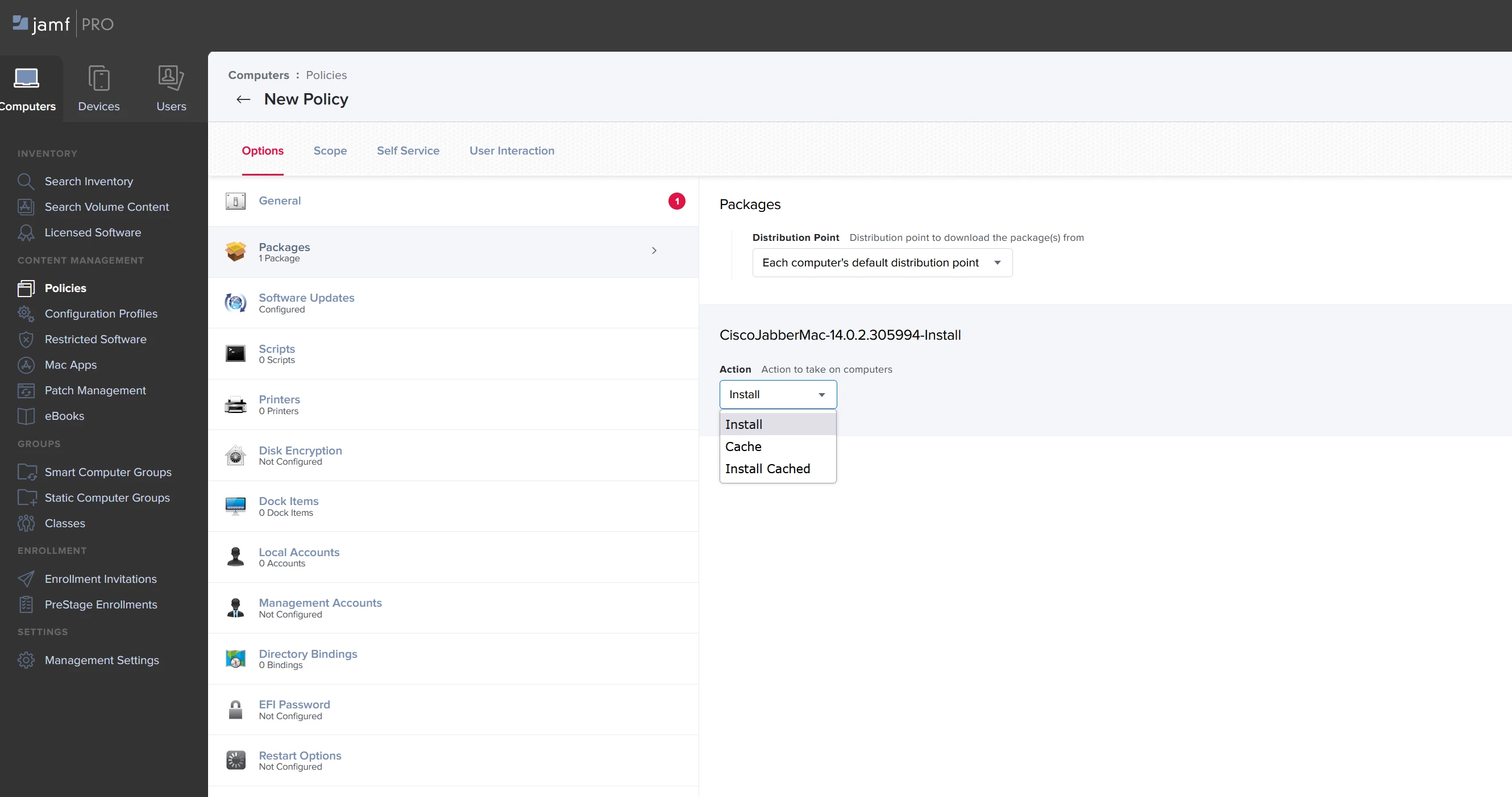

Hi All,
I am trying to uninstall app using jamf pro.
However, when i tried to select uninstall from the action menu - i dont see uninstall option.
https://docs.jamf.com/10.24.1/jamf-pro/administrator-guide/Uninstalling_Packages.html#:~:text=Select%20the%20Packages%20payload%20and,the%20settings%20for%20the%20package.
Am i missing something here?

AJPinto
  • October 28, 2022
You need to upload the package as a .dmg, and you also need to index the .dmg in JAMF Admin. Once that is done the uninstall option should appear. This is not possible with a .pkg.
On a side note, I recommend putting file extensions on your packages. Not having a file extension can confuse things.
