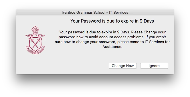

Hey all,
I made a BASH Script to check when a user's AD Password is going to expire (AD Bound machines only) and prompt the user to change if it's less than a number.
Check it out: https://github.com/DJStuey/PasswordChecker
Feedback Welcome
BASH script in JSS, triggered with Policy to launch Once per day on Recurring Checkin. JamfHelper window only pops up when the Expiry is less than the Notify Variable.
Hope this helps someone!

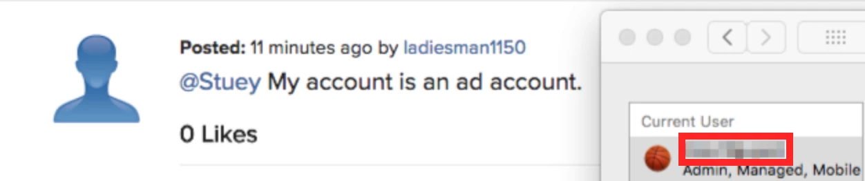

  • May 10, 2018
@Stuey My account is an ad account.
  • May 11, 2018

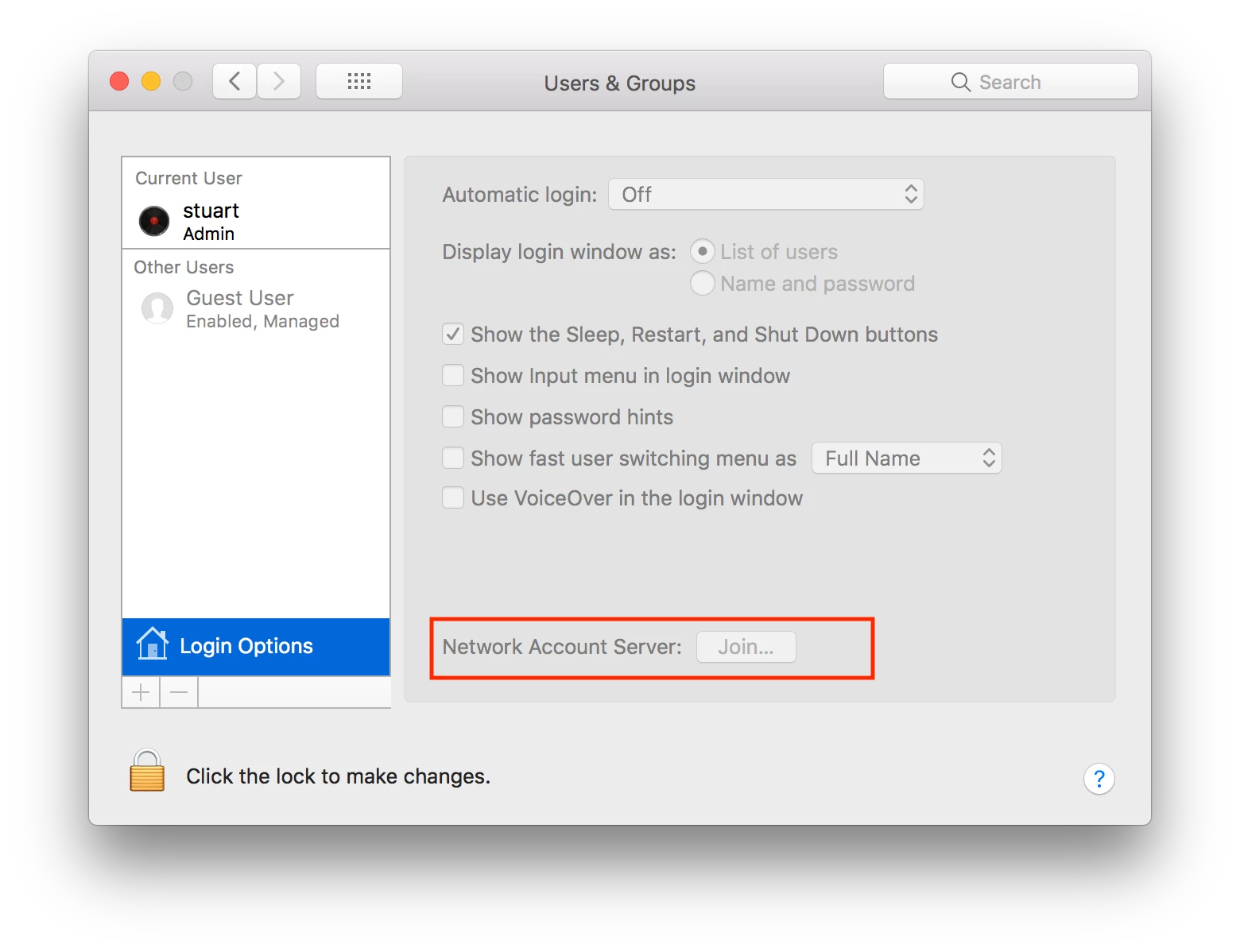

interesting.... that indicates there might be an AD Connection issue then. As to get the negative number, dscl must be returning either 0 or failing to hit your Active Directory.
Have you confirmed that the Domain variable is set to your actual Active Directory Domain?
You can get it from the "Login Options" pane of System Preferences -> Users & Groups, it'll be next to the "Network Account Server" field at the bottom. (Not pictured here because I'm running on an experimental, non AD Bound machine)

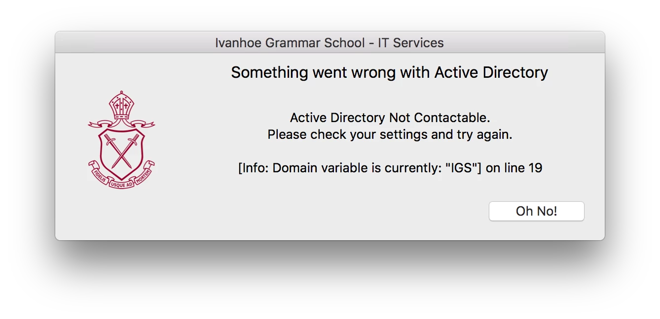

I've added some Error Checking to the section that requires AD.
This also has the benefit of being able to alert you/Users if their AD Bind is busted.
Re-clone the Github repo for the latest changes.
