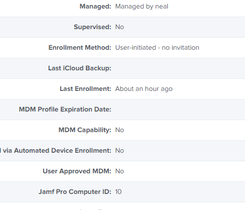

I wiped the device and I reenrolled through self enroll by going to mycompany.jamfcloud.com/enroll, I installed and approved the mdm profile but when I go to search inventory I see the computer but it is not managed
How do I resolve this? I'm not able to remove the profile on the macbook, I tried a bunch of sudo jamf commands but it won't turn on the management of this machine.

This is an Apple M1 2020 macbook with latest version of monterey
