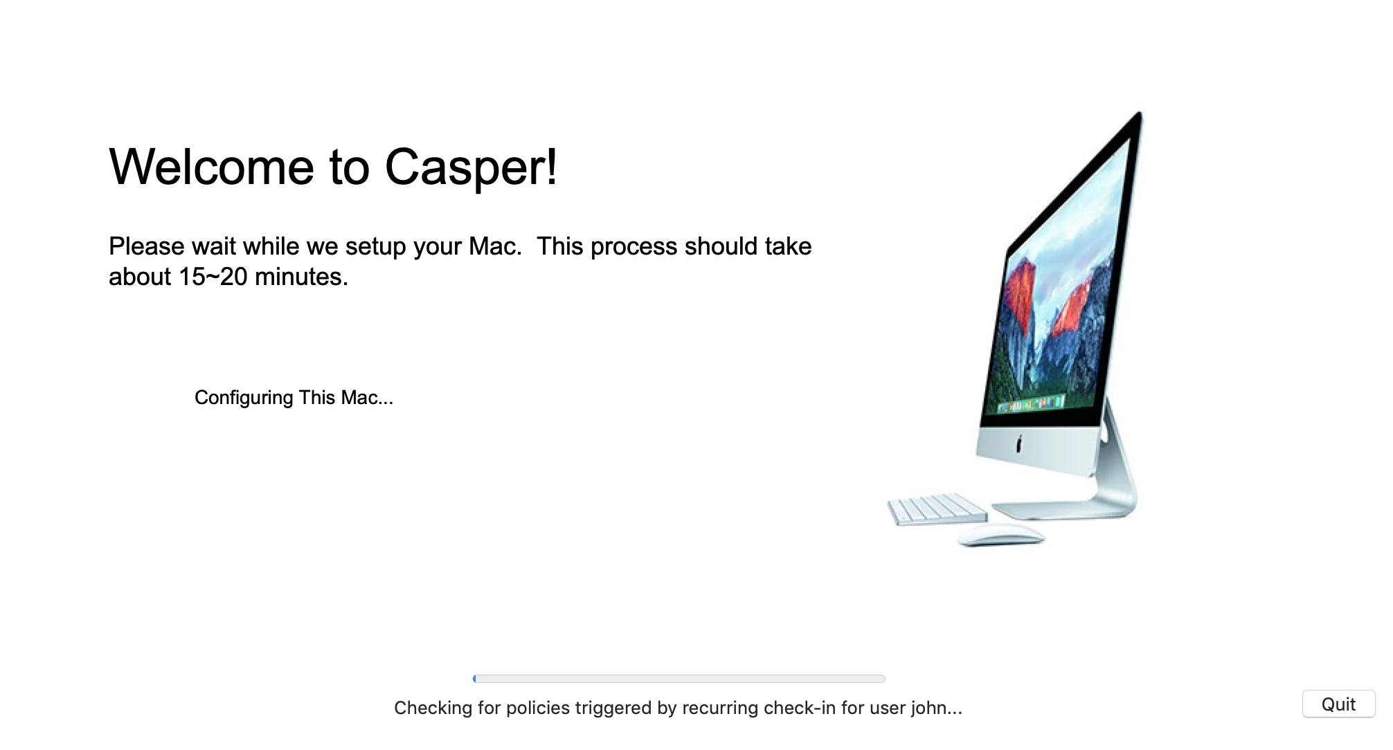

@loceee Is that helper script working reliably for you? For me, it's failing to change the html loaded in about 75% of the time. That forces it to stop before it sets the build time, quit button, fullscreen, etc. It always fails in the exact same way, but it doesn't always fail. I think it'd be less frustrating if it was consistent one way or the other. The path to the replacement html is /PS/index.html. Here's the error that pops up most of the time:
Running script COE - Progress Screen Helper...
Script exit code: 1
Script result: 32:89: execution error: An error of type -10810 has occurred. (-10810)
Traceback (most recent call last):
File "/Library/Application Support/JAMF/tmp/COE - Progress Screen Helper", line 145, in
main()
File "/Library/Application Support/JAMF/tmp/COE - Progress Screen Helper", line 105, in main
subprocess.check_output(osa_full_command)
File "/System/Library/Frameworks/Python.framework/Versions/2.7/lib/python2.7/subprocess.py", line 573, in check_output
raise CalledProcessError(retcode, cmd, output=output)
subprocess.CalledProcessError: Command '['osascript', '-e', 'tell application "ProgressScreen"', '-e', 'set htmlURL of every configuration to "/PS/index.html"', '-e', 'end tell']' returned non-zero exit status 1
Error running script: return code was 1.
It should be noted that when everything is run outside of enrollment, it works perfectly 100% of the time. It only has these errors if it is run at enrollment.

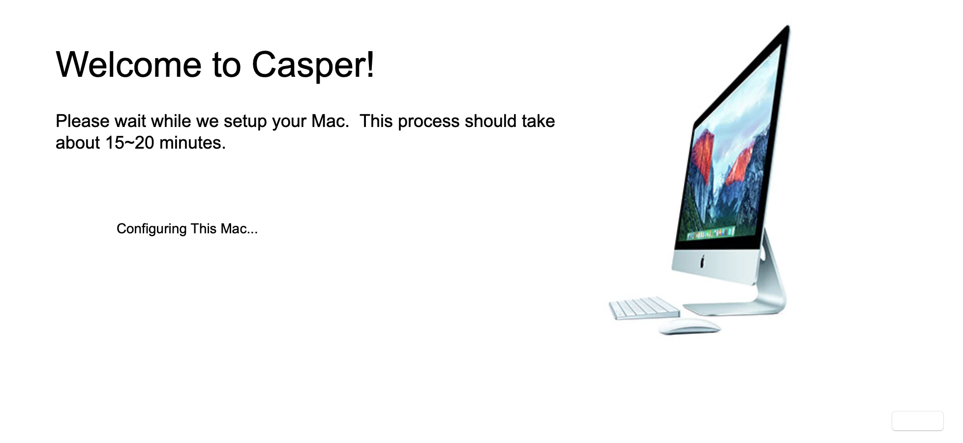

I managed to resolve my issue. For whatever reason, the progressScreenHelper.py file would not run correctly if run through JAMF. If I had to guess, I'd say this is because JAMF uses the System user when pushing things.
To resolve this, I included the progressScreenHelper.py script in the package that places all the needed files and added a postinstall shell script to launch it as the currently logged in user. It looks like this:
## postinstall
# Finds the current user's account
currentuser=$(/bin/ls -la /dev/console | /usr/bin/cut -d ' ' -f 4)
# Runs the script as that user.
su -l $currentuser -c "python /PS/progressScreenHelper.py --start /PS/index.html --fullscreen --hidequit --buildtime 3600"
exit 0      ## Success
exit 1      ## Failure
In my testing, this way of launching things works every time while leaving it to run as System failed more than 60% of the time.
