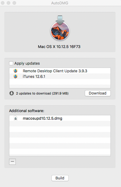

First off, I know many of us use different processes; DEP, thin imaging and many more. We had an issue with the new iMacs coming in requiring a different build and I wanted to share what we did.
We used the standard tools to get this working utilizing AutoDMG and AutoCasperNBI.
Using the tools mentioned above, we found there was an update at Apple for these new iMacs:
https://support.apple.com/en_US/downloads/macos
We then proceeded to run AutoDMG and adding the typical Sierra download as we always have done, the required build for these 2017 Macs, we couldn't find a way to download the needed Sierra build. We added this new update package mentioned above, to AutoDMG so it would add the package to the final AutoDMG build. This created a new OS.dmg that was the correct build for the new iMacs, build 16f2073.

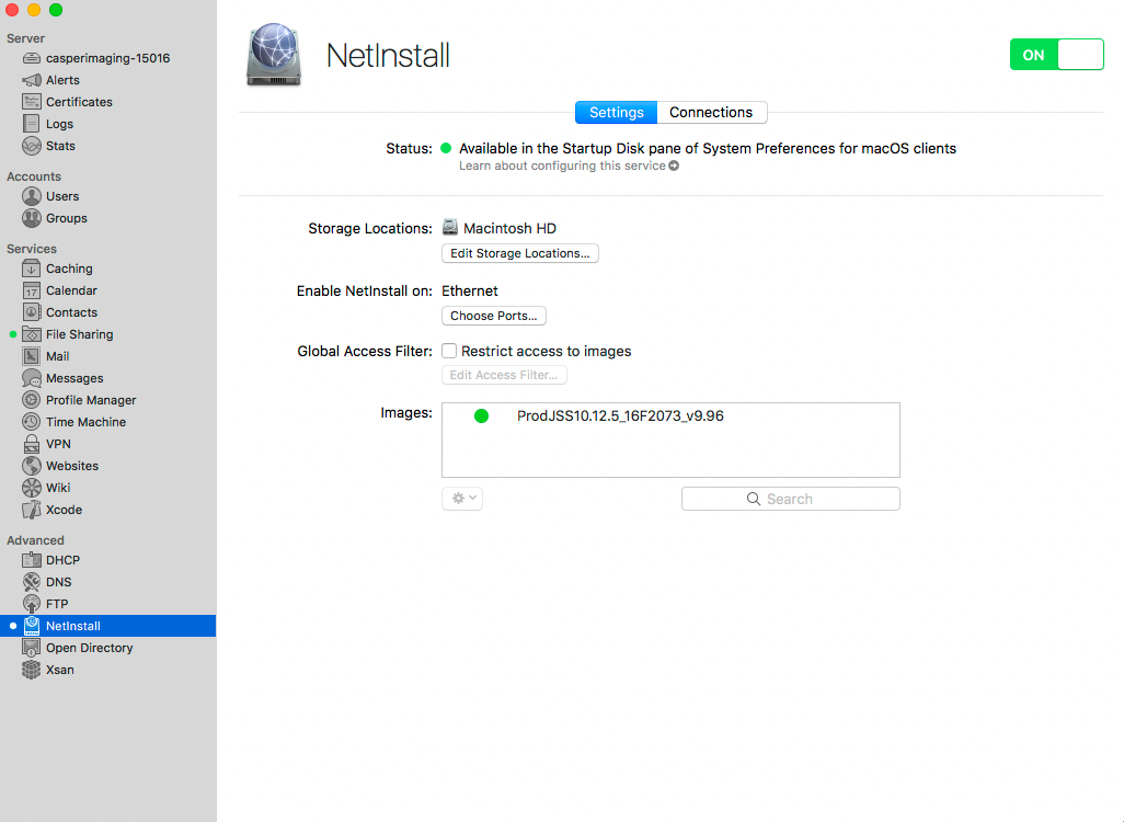

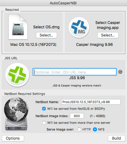

We then used AutoCasperNBI to build the new NetBoot image, this worked just fine to build the correct OS and it NetBoots our new iMacs.
I thought I would share this process for those that need to NetBoot, image the new iMacs.

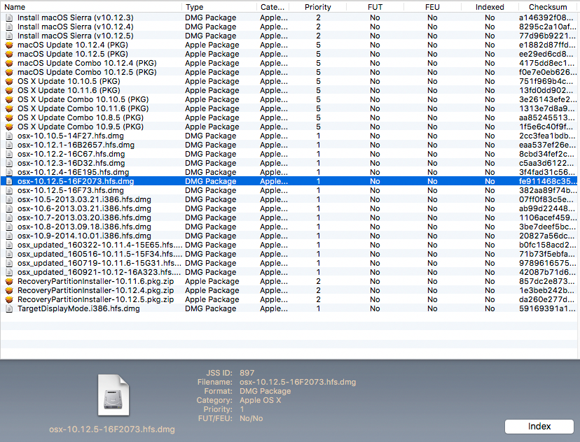

UPDATE: It worked, naturally. It's also worth noting that it's imperative to include the newly created DMG with the 16F2073 build in Casper Admin as the DMG used during imaging if you're wiping the macOS device first.

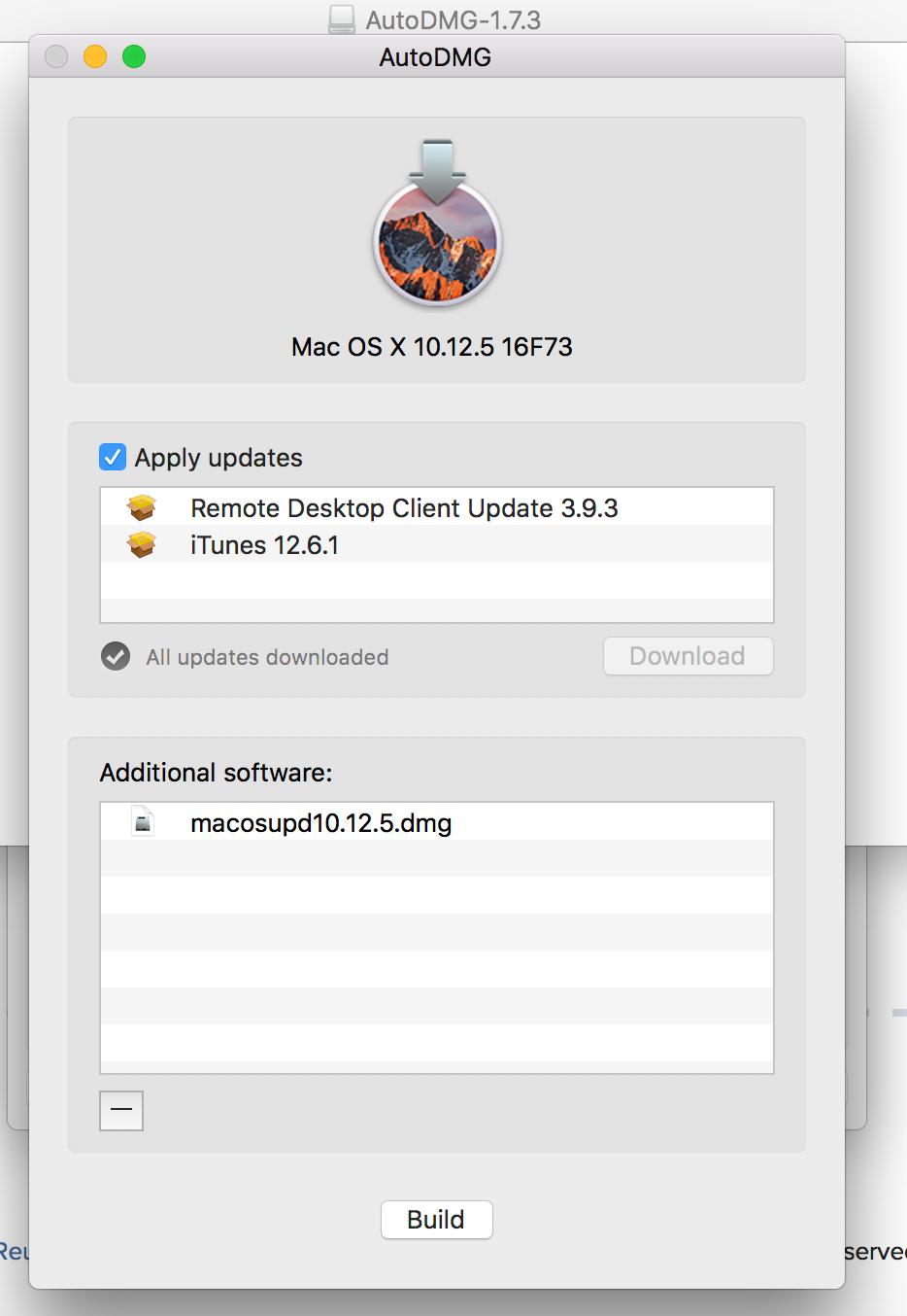

  • Jul 13, 2017 4:48 PM UTC
@jeandelgadoc I grabbed the 10.12.5 from here and completed the above steps using AutoDMG. The result of that DMG was a 10.12.5 DMG with the 16F2073 build. Only difference is that I did not opt for the "apply updates" section in AutoDMG but I can't imagine that having an impact on the DMG itself.
