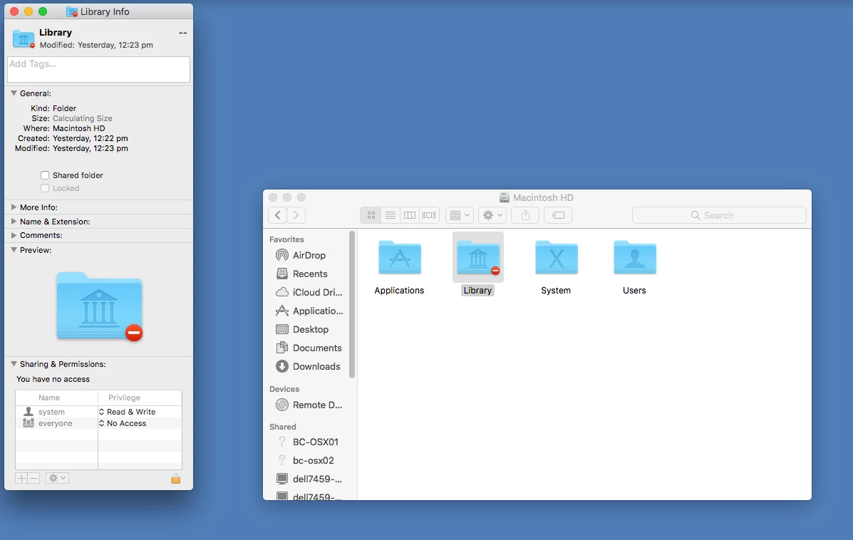

I've created a Base Image doesn't include any additional software just a local admin user using Composer.
Followed the steps from this article [https://www.jamf.com/jamf-nation/discussions/22840/guide-to-creating-sierra-base-image-from-a-to-z](link URL)
Issue is after it images and boots to the HD there is no desktop background and upon checking the Library folder the permissions are all wrong.
