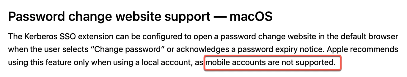

I'm trying to wrap my head around what you mean here. Are you saying that new accounts on a machine have to walk through setup assistant to create and can't just be handled by logging in at the login screen?
We have a login screen config profile that forces all computers to a login screen with only username/password fields and a script that runs at enrollment binds the machine to our on-prem AD. I'm guessing the SSO extension wouldn't work in this sort of setup?
Have you tried deploying the SSO extension to machines that already have Roaming Profiles , or is going to Kereberos SSO profile something you have to switch over for new enrollments?
AJPinto
  • Dec 8, 2023 8:50 PM UTC
Note, the Kerberos SSO extension does not provide on demand account creation like domain binding does. However, the Platform SSO extension does which is setup similarly.
When you bind a Mac to the domain, the log in screen will call the domain controller to validate the user account and logs the user in building their account if necessary. Honestly, from the domain binding experience this is about all that really works.
If you are logged in using a Mobile Account, the Kerberos SSO Extension will still install but it won't do anything.
https://hcsonline.com/support/white-papers/a-guide-for-configuring-the-macos-catalina-kerberos-single-sign-on-extension
https://www.apple.com/za/business/docs/site/Kerberos_Single_Sign_on_Extension_User_Guide.pdf
The Kerberos SSO Extension has no way to build users accounts on a Mac. It relies on the account to be built some other way like macOS Setup Assistant, or manual account creation (GUI, CLI or tools like JAMF Policy which is CLI under the hood). Once the user logs in to macOS with that account, they log in to the SSO Extension. The SSO Extension then prompts them to sync passwords and will update the local account PW to match the network password and generate Kerberos tickets. However, the Kerberos SSO Extension does not care what the user name is.
Apples Platform SSO does support on demand account creation, which was a massive oversight with Kerberos SSO Extension.
