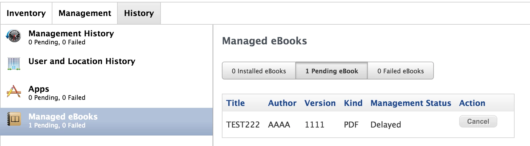

Hi everyone,
I am working on deploying some in-house eBooks (PDFs, actually) to my test iOS devices. Unless my google-fu is off today, I wasn't able to find any other posts/information on why I might be having this issue.
I have a JDS set up and am able to successfully upload my PDFs to it from my JSS. I have them scoped for a test iPad and can see the PDF available in Self Service on the test device.
The problem comes in when I click the "Install" button within Self Service to install the PDF. It shows successful within Self Service, but when I check the logs for the device on the JSS (Device -> History -> Managed eBooks), it shows the book, but under the "management status" column, it says "Delayed" (see screenshot). I've let it sit for about an hour (actually a bit longer) and the status never changes.
I've deleted and recreated the book, and I've gone so far as to set up a brand new JDS and I still experience the same issue.
Any thoughts would be appreciated.

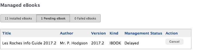

We experience this issue a great deal, the larger the PDF, eBook or iBook, the worse the issue. We are using JAMF hosted with a cloud distribution point.
The attachment shows a 145Mb iBook that has been waiting for days.
