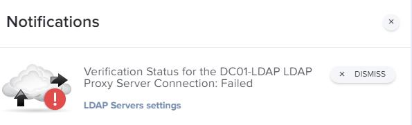

Hey, could you fix this issue? I get this notification:
And the status is shown as "Disabled"
Does someone know what to do?
