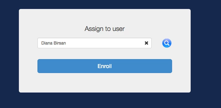

So I'm trying to find a way to get users to put in their information (Name, Department, Title) during enrollment so that the machine becomes associated to them. We don't run ldap here so I'll be providing either an email invitation or directing them to our enrollment page and giving them an enroll user to use. I want to have policies based on department but would have to go in manually after getting the user enrolled to set this up.
My first thought was to have some sort of script run after enrollment to request this information in cocoa dialog and then use apis to update the info per machine but I'm not very advanced in script writing...
Does anyone have any thoughts about this?
Another oddity I'm experiencing is not even being able to select a user that exists in "Users" in my JSS when enrolling. My second plan was just to use an api to input an XML for all users which would then allow them to select themselves on the "Assign to User" page of the enrollment process... but I type in my name (which I know exists in Users in my JSS) and hit the search button and nothing happens, I can't continue to the download page for the quickadd either until I clear the field. Thoughts?

I believe you have to type the username.
I would use a combination of Apple Script dialogs and the jamf recon command to add the appropriate information. Do "sudo jamf help recon" so you can see the flags:
