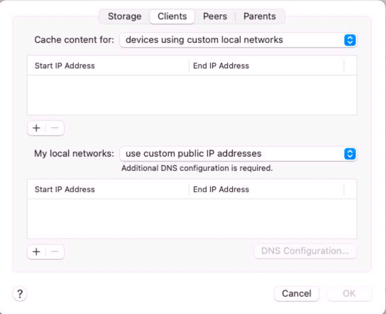

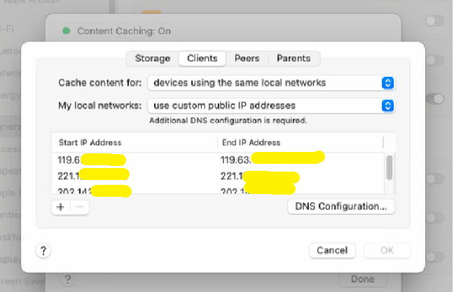

Cache content for : Devices using the same local networks:

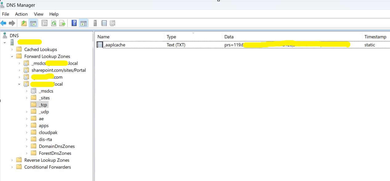

My local network setup: I’m using custom public IP addresses. I've listed four possible public IPs, and at any given time, one of them will be used by my content cache server.
then from DNS configuration i coied windows command.
Step 4: run that command into my local dns server

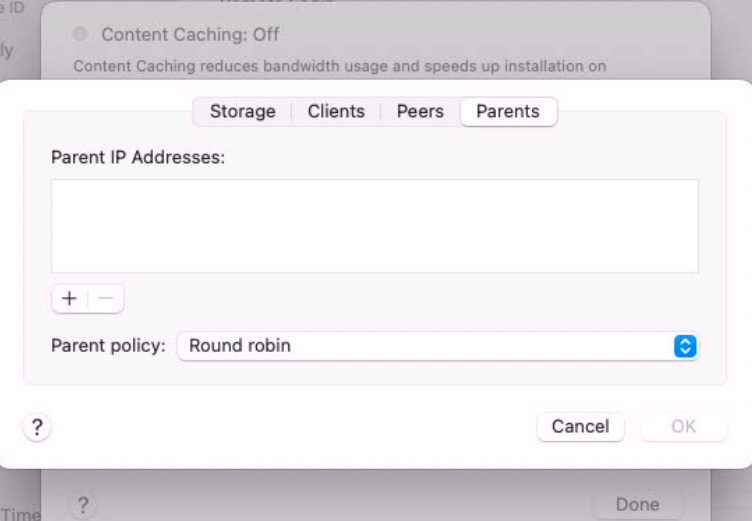

Peers and parents setting not done yet. As setting up 1st server. when i dig at client machine it can resolve dns query but when use AssetcacheLocatorUtil device says 0 cache content found.

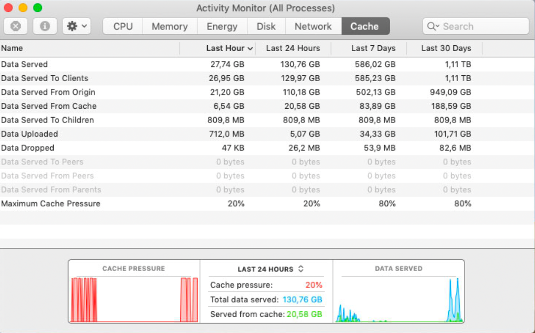

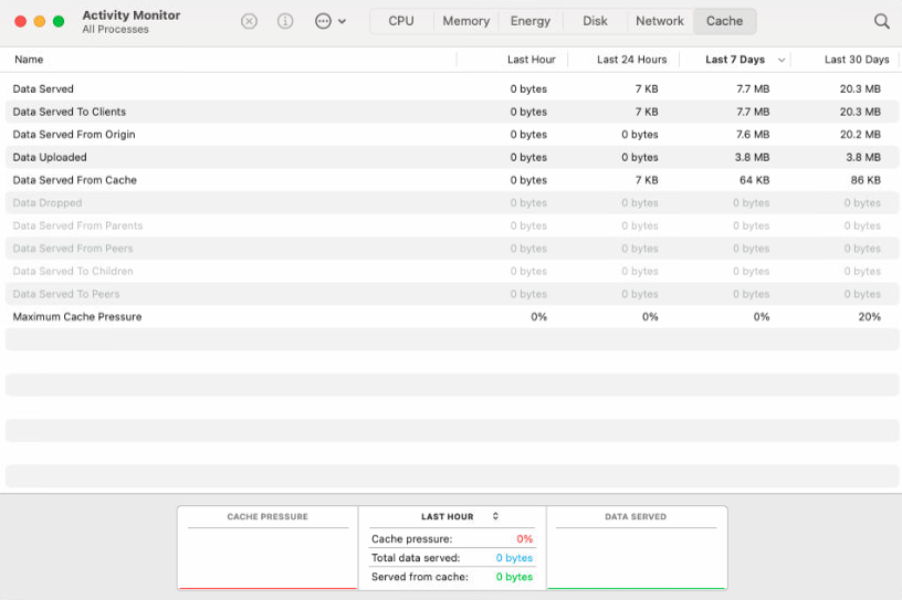

Below are the stats since i turned on content cache. Sequoia updates are on hold from jamf just because we want to setup this server first so that devices can use cache.

  • Technically cache server and devices public IPs are not same but i assumed that i added content cache public IP in txt record so they can find server in local network.
-->> This is because you are using "Devices using the same local network"
you can scan IP using Angry IP scanner app / ask the IP range to the Network Engineer team to add IP in " Cache Content For > devices using custom local networks "

preparations that can be done:
1. prepare List public ip
2. prepare List local ip (IP range in all VLANs)
for example in mine there are 2000 IPs
192.168.0.1 - 192.168.20.255
3. List IP Content Caching (if there is more than 1 mac Content Caching)
4. Prepare one of the Mac Content Caching IPs from the highest spec (Ethernet Speed ​​and large Storage) , become Parent .
Start:
Open System Setting > General > Sharing > Content Caching ( press button i )
Advanced Option
** If you only see Option, press the keyboard option, then Advanced Option will appear.

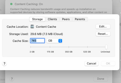

Set the storage to be used
Clients Settings
Content Caching For > Device Using custom Local Network ( No2 . IP range in all VLANs, Start 192.168.0.1 -  End 192.168.20.255 )
My Local Network > Use custom public IP Addresses ( Enter the public IP that you have, start and end with the same IP, If there are 3 public IPs, add + to the three public IPs. )
Peers Setting

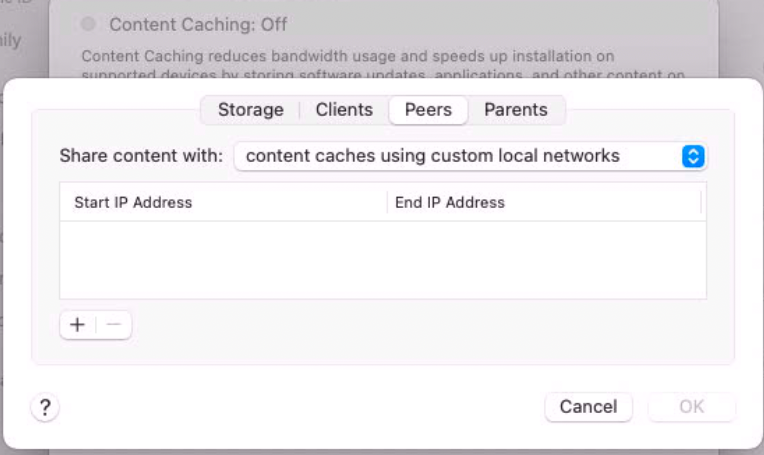

Share Content With > content caches using custom local Network ( No 3. IP Content Caching , If you want each caching content to share with each other, enter All IPs of Mac Content Caching )
Parents Setting
Enter the IP of one of the Content Caching MACs that has the largest storage and fastest Ethernet speed as the parent.
here i use Round Robin setting.
