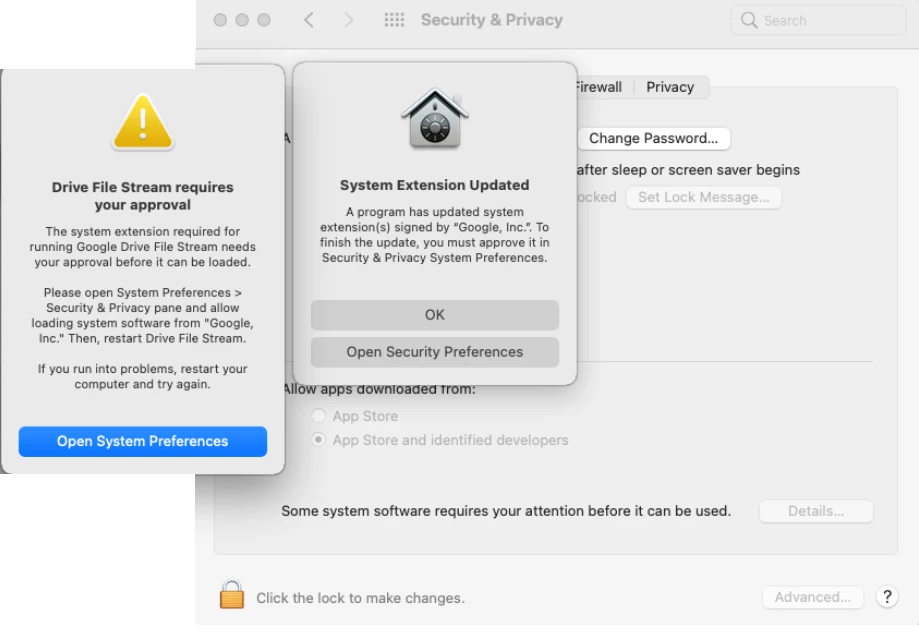

Hi,
Using the script below I can silently install Google Drive on the workstations. I just run into the following problem, and that a pop-up appears from System Extension Blocked, in which I have to approve Google.
Is there a way to forcefully approve this in the script?
Thanks in advance.

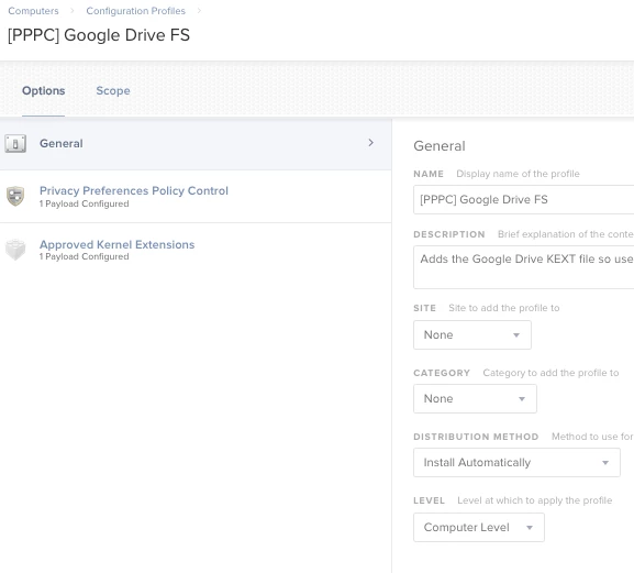

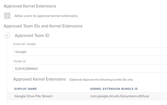

Config profile with Approved Kernel Extensions payload.
  • January 22, 2020
We do exactly what @cbrewer does and use a PPPC entry in the same profile.

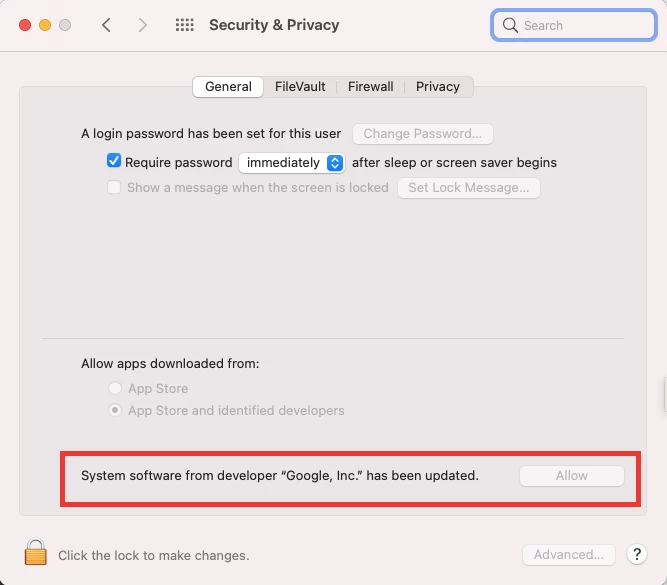

In Big Sur I still haven't found a way to approve the necessary System Extension via Jamf...but it is possible to open System Preferences, Security and Privacy, General Tab, click Allow, reboot...then it works great. Hoping someone can find a fix or this is resolved by Google at some point.

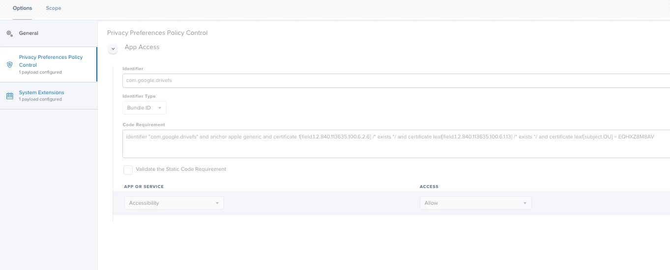

Hey @RLR ,
we use the following:
Privacy Preferences Policy Control - App Access
Identifier
com.google.drivefs
Bundle ID
identifier "com.google.drivefs" and anchor apple generic and certificate 1[field.1.2.840.113635.100.6.2.6] /* exists */ and certificate leaf[field.1.2.840.113635.100.6.1.13] /* exists */ and certificate leaf[subject.OU] = EQHXZ8M8AV
APP OR SERVICE:
Accessibility: Allow
System Extension:
Google Drive - Allowed System Extensions - EQHXZ8M8AV - com.google.drivefs.filesystems.dfsuse
Hope that works for you :). Feel free to give some feedback!

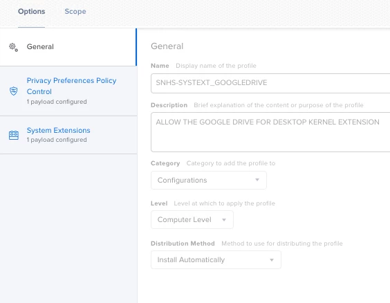

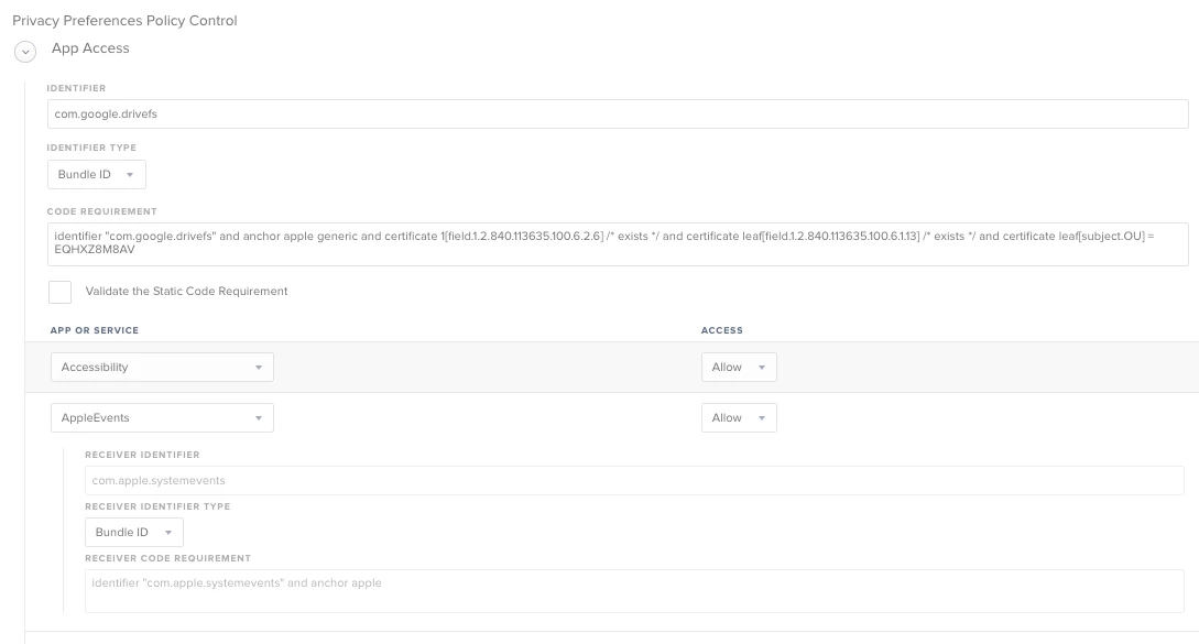

@RLR  and @konstantinb    since it's not GOOGLE DRIVE FILE STREAM anymore but changed to GOOGLE DRIVE FOR DESKTOP  are the values to create the  'system extension' the same? I used the values that @konstantinb provided in the reply above two weeks ago.  (images attached of my sys ext config profile)
specifically these values below, do they stay the same?  i'm thinking maybe 'drivefs' would reference 'file stream' but since it's not file stream anymore i'm kinda just assuming.
---- com.google.drivefs
----- com.google.drivefs.filesystems.dfsuse
  • September 1, 2021

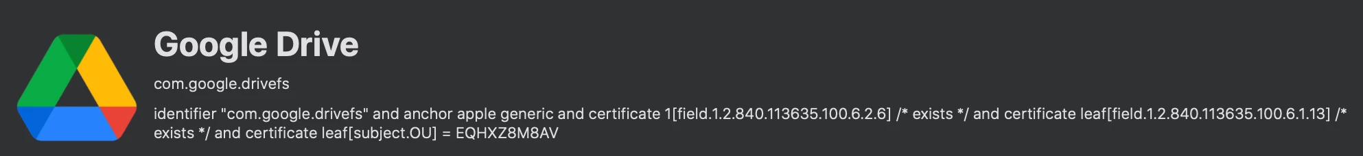

Pulling the App "Google Drive" Into PPPC Utility it shows the same as before, so looks like it is indeed still using the com.google.drivefs. I wondered the same thing 🙂
so does my Config Profile settings look correct?
is that similar to your config profile?
does it work for both intel and M1  macs running Big Sur?  I'm testing but wont be able to for the next 2 weeks.
  • September 1, 2021
Testing on an Intel Machine in a bit need to wipe to fully test properly, will post results when done. I have the same as you plus a few others, which I likely do not need, The diff is that I approved both com.google.drivefs and com.google.drivefs.filesystems.dfsuse in the system extension, so we will see what happens. If it works I will post screenshots.
  • September 1, 2021
Also Testing this on macOS Monterey Beta FYI, 1 Big Sur Intel and 1 Monterey.
