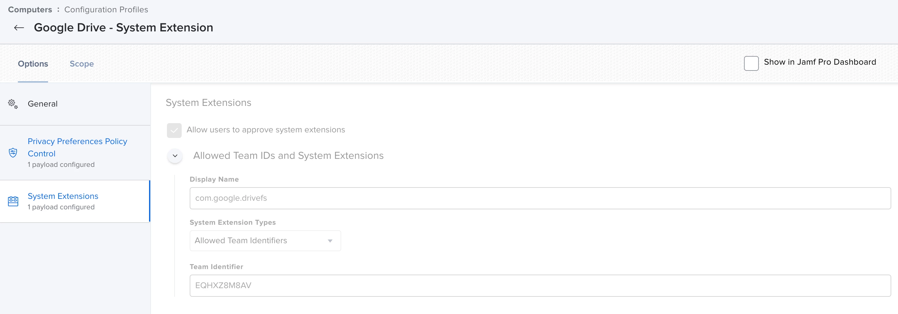

Ok So Here is what I have:
Big Sur on M1 = Works
Big Sur on Intel = Fails
Monterey Beta (21a5506j) on Intel = Works
Monterey Beta (21A5304g) on M1 = Works
My setup is a bunch of me reading various items and is likely overkill, I was going to make a bunch of settings and then if it worked I could pull some back, just keep that in mind.
(Update) same results after changing a mistake i had in the screenshots below:
com.google.drivefs.filesystems.dfsuse

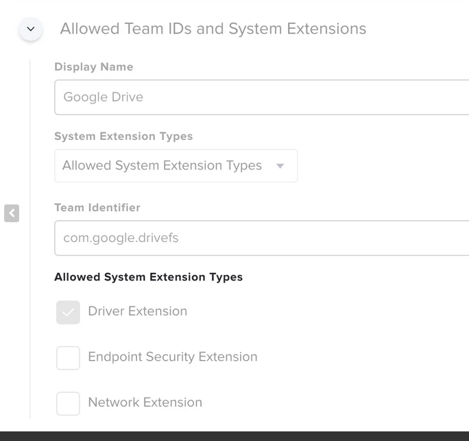

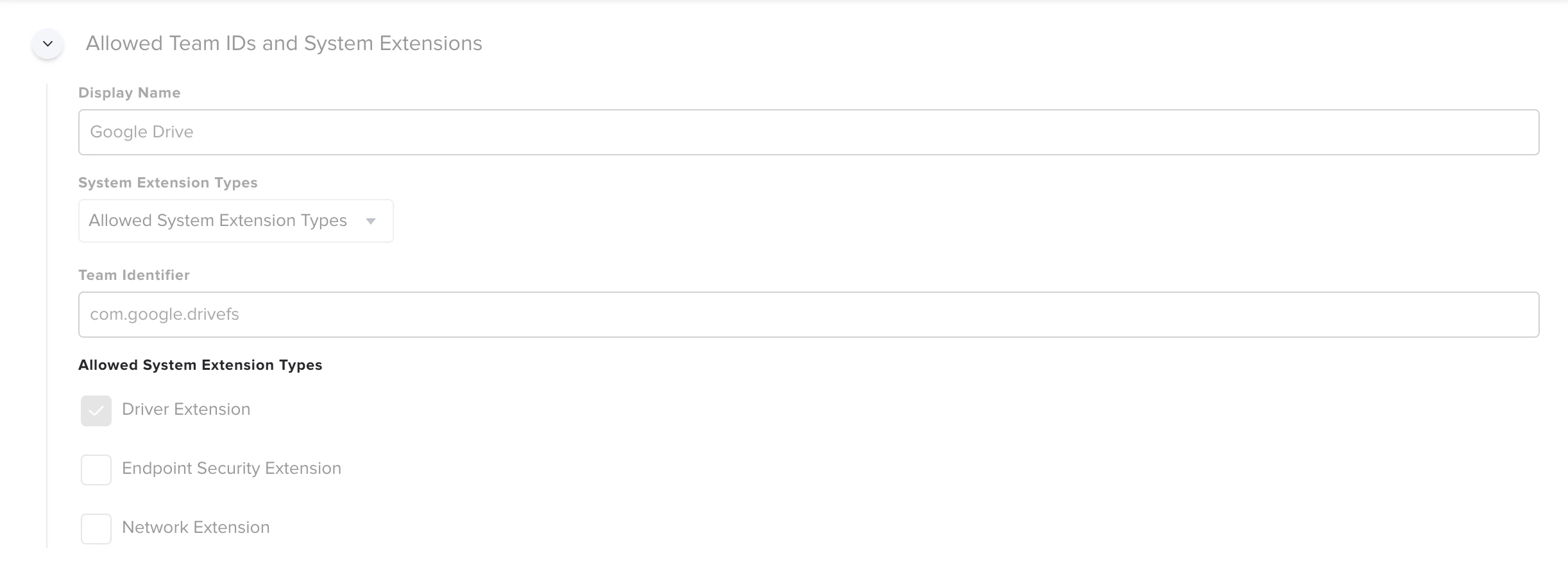

@konstantinb @Geissbuhler  are you applying this Google Drive system extension config profile to only Big Sur computers?
and a seperate Google Drive kernel extension config profile to Mojave and Catalina computers?
also the system extension you configured, I see the pictures you posted, does the config profile have 2 'Allow Team IDs and System Extension' sections in it?
  • September 3, 2021

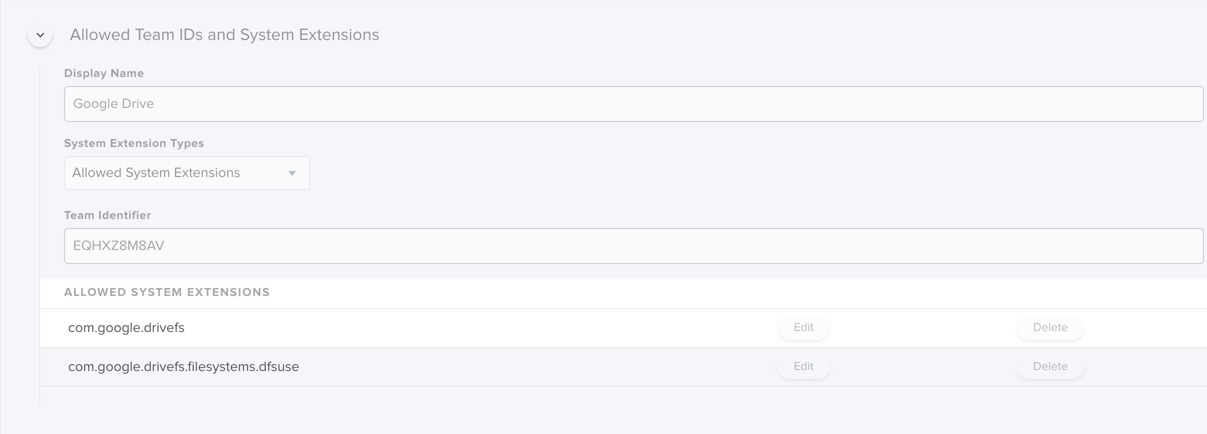

@tcandela Theoretical yes you would need to.
The Systems extensions are as following:
Display Name:
Google Drive
System Extension Types:
Allowed System Extensions:
Team Identifier:
EQHXZ8M8AV
ALLOWED SYSTEM EXTENSIONS:

I'm confused with the @Geissbuhler images he attached to his reply specifically the 5th image that has the 'driver extension' box checked. Do you have that in your system extension configuration?
here is the image i'm talking about, it looks like another section of 'Allowed Team ID's and System Extensions' was added to the same config profile

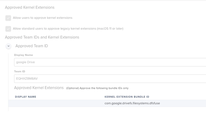

I got one to work with an intel computer with 10.15 on it with a kext. I noticed that there is a letter missing in the com.google.drivefs.filesystems.dfsuse it should be
com.google.drivefs.filesystems.dfsfuse  notice that there is a F missing from the first one.  Never got anything about allowing and never had to go security and privacy to do anything
  • September 8, 2021
Thanks! Actually you are totally right this is missing.

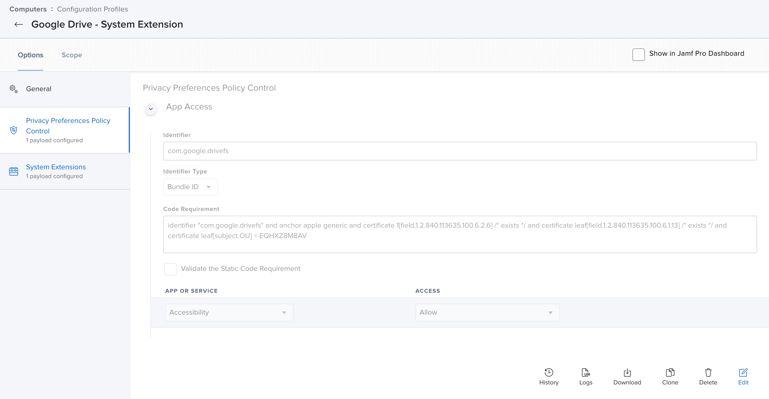

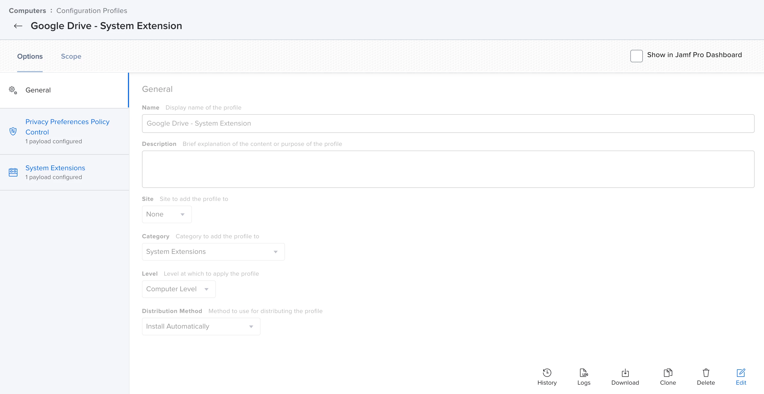

Yes in my test environment I was basically trying anything, hence the comment where I try way too much and scale back later. The way those pics are listed, is the top pic is the Config Profile as whole, then the next is of the PPPC Payload, The next is the System Extensions payload, the following snaps are of the individual sections within the System Extensions Payload.
I read early on that if you are unsure with System Extensions which bit works, like in this instance here, trying to troubleshoot, you start with approving the team as a whole, Then start on the individual extensions, Then the types, if your big old way overkill sys extension works, scale it back like maybe delete the Team as a whole bit of the payload, and get right to the bits that you actually need.
This is not in prod
Would love to know what I actually need, hence the testing above. This is currently working on Big Sur with M1, but not working on Big Sur with Intel.

I haven't tried it on a Big Sur computer yet.   I was trying to find a solution for my 10.15 computers. This is a kernel extension so i know it will not work on Big Sur I am making a new config profile for my Big Sur computers will let you know how the testing is going after I get that one built.

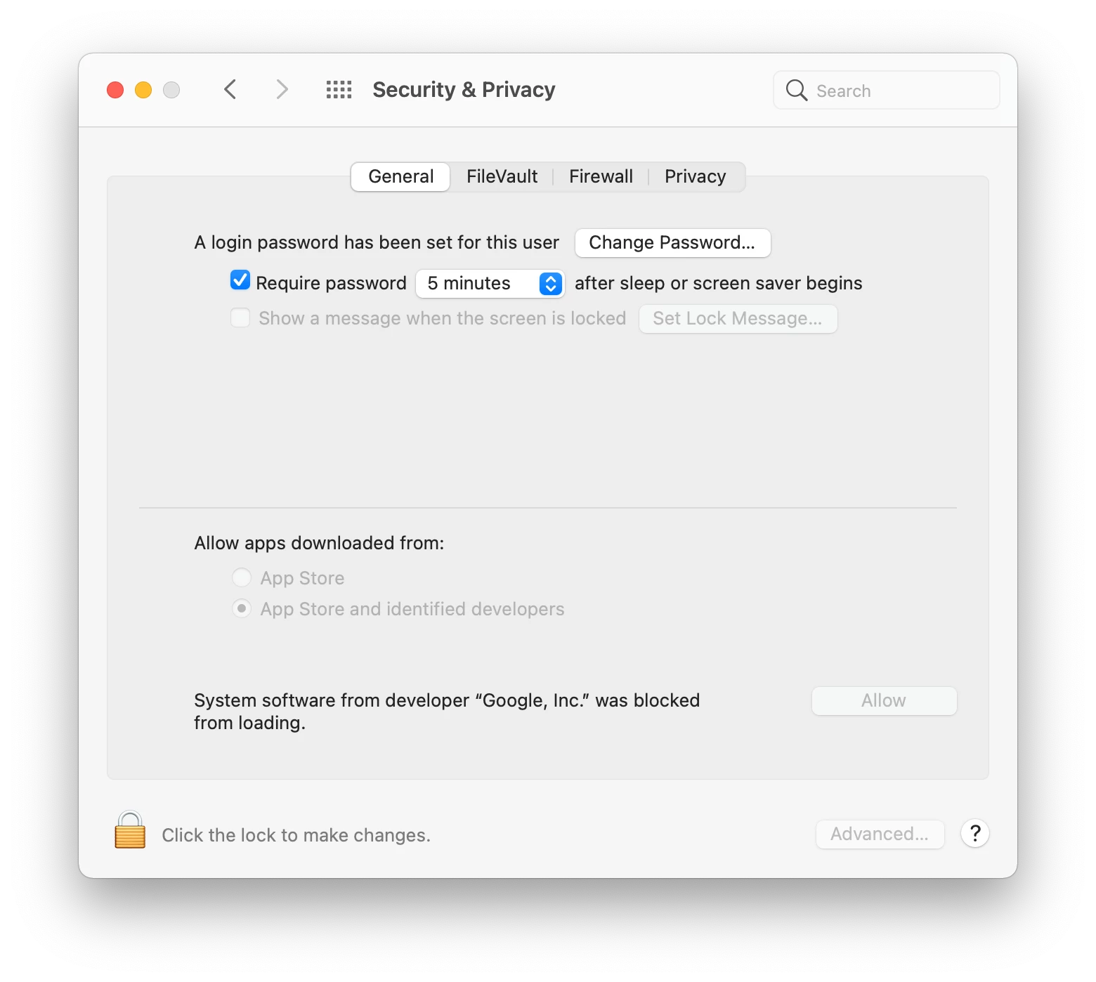

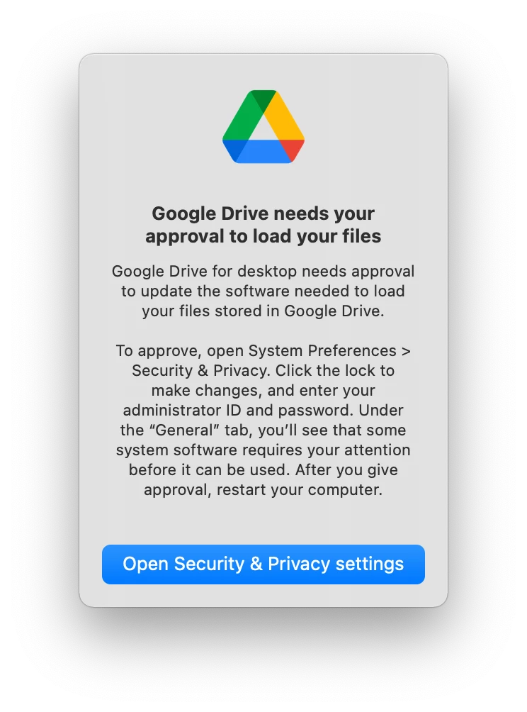

Even with that and a reboot, I am still seeing this:
  • September 8, 2021
With M1 and Big Sur
Forum|alt.badge.img+20
  • September 9, 2021
@Geissbuhler  those are the same popups i get when installing google drive for desktop. I have users install google drive via self service (using the pkg provided directly by the google drive download).
  I haven't applied any system extension config profile yet.
Did you apply the system extension config profile before installing google drive?
are you testing on both intel and m1 ?
