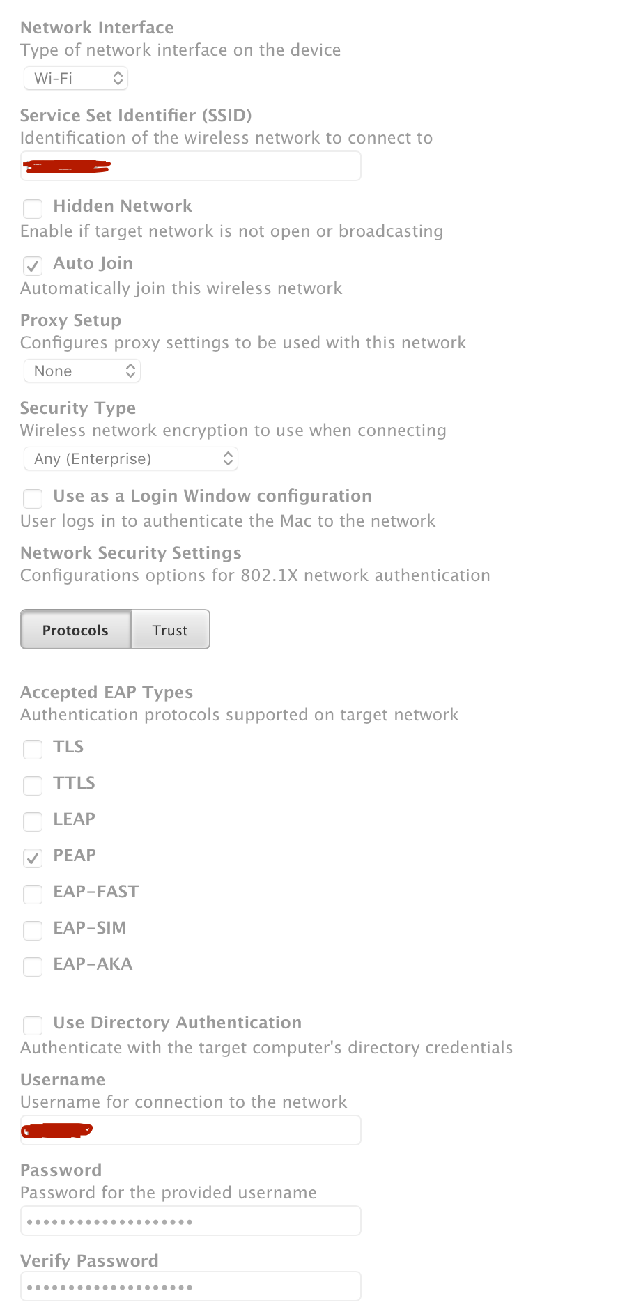

Here is how the computer level profile is setup with the trust certificates:

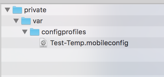

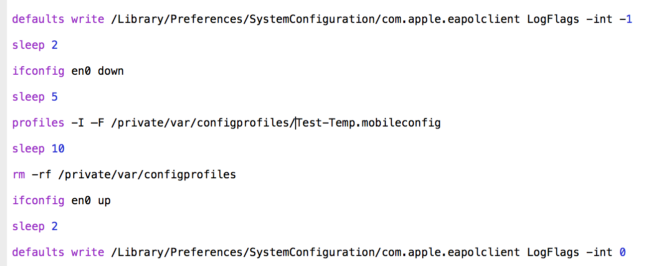

Here is how I have the package and post-install script setup:
This is based off of a package we currently use that does the same thing for another network and it works, I just changed the mobileconfig name. Truthfully I am not sure what the defaults write commands do but I have tried commenting them out and it does not help. I have also tried running the profiles command and sudo in the script and still it will not install the profile. I have even tried different Security types, technically a WPA2 Enterprise network.

The default commands turn debug logging on and off. Only useful if you are working with those logs for troubleshooting.
That said, try it with a postflight script and just the profiles command since the rest are not necessary. I think postinstall scripts only run the first time you install that package, so if you re-install it later it won't execute. That could be the issue.

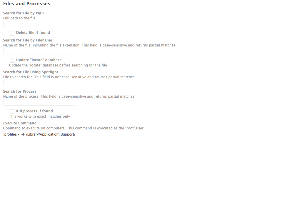

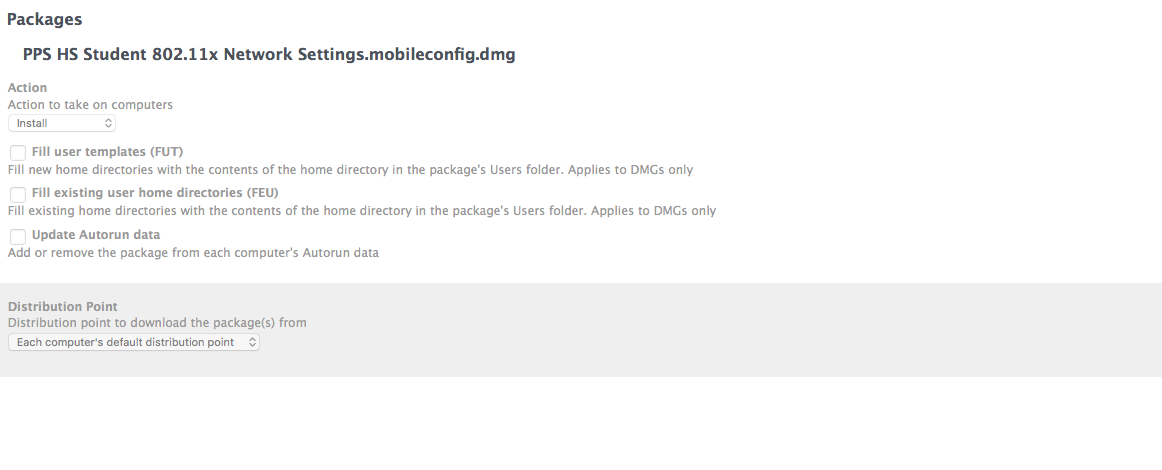

So we do this slightly differently. We create that profile then I made a composer DMG of that profile stored in the /Library/Application Support/JAMF folder.
Then I run a command to call the profile. I even put it in self service so if its not working they can reinstall it.
profiles -I -F /Library/Application Support/JAMF/Wireless Profiles/PPS HS Student 802.11x Network Settings.mobileconfig

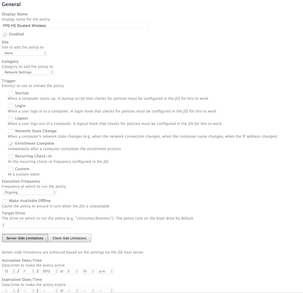

Our policy looks as follows
Gabe Shackney
Princeton Public Schools
