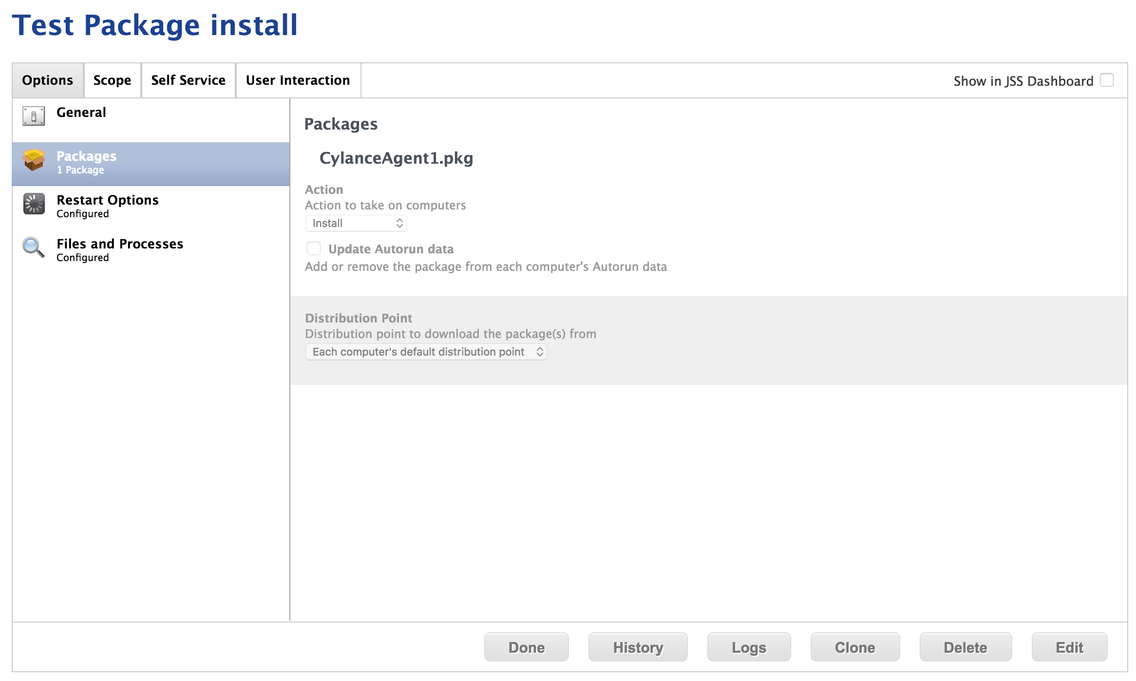

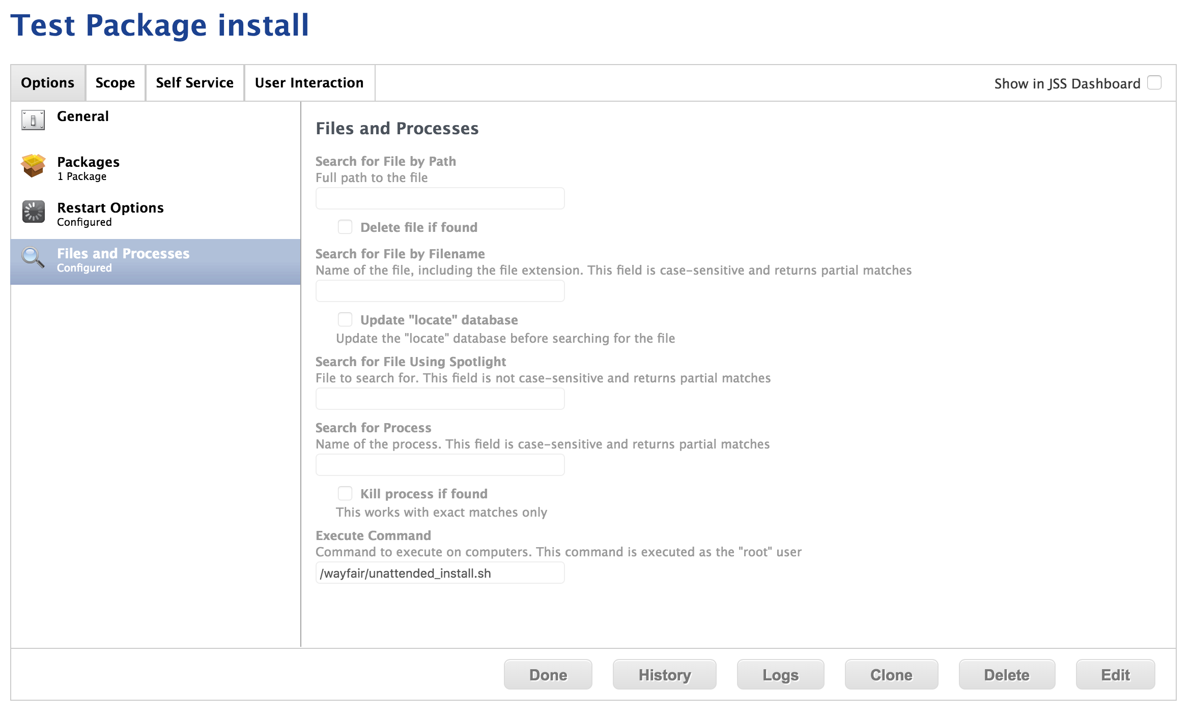

  • July 6, 2016
@jonathanla
This may not be the correct way to do this but it is how i got it working.
This is my package before it's actually packaged in composer:
The policy runs and this package and all contents are delivered and extracted to the target machine:
next this is how my policy is set up:
You can see that the policy moves the files over, then runs a script that imitates the actual install process.
I use the commands in the above comments, that has not changed.
Again this may not be the expected way to install cylance but it's been working for me. let me know if this helps at all.
Please let me know if this helps, or if i can explain it better.

  • July 8, 2016
@sedwards00
It's actually written above in one of my posts but heres a screenshot (obviously place your token in the right spot in the script)
Are you getting any errors when it fails?
