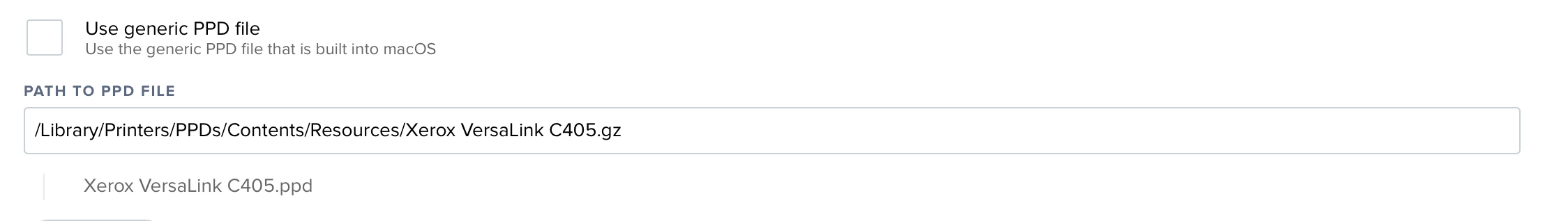

We have Xerox printers and we deploy the drivers as a package, then we deploy a policy to "Map" the printer (you have to setup the printer in the Jamf Pro options). That policy is also available as self-service item for the cases we need to reset the printing system (right click on the printer in the system preferences, solves a lot of weird issues).
In case it gives you ideas :
@Xaviermlp Sorry, what am I looking at? You got a gz to show as ppd?
  • February 26, 2019
I point to the gz containing the ppd that was installed by the xerox package. And this allows me to map the printer correctly through a policy.
can you explain?  what you mean by point to gz?
