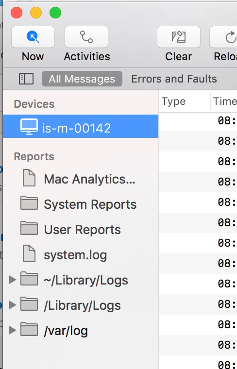

Still trying to get to the bottom of this. Do you know how to set the value kloglevel in the nsmb.conf file? That is what are the valid levels?
Regards,
David

I'm not exactly sure on kloglevel. I found this article, but I'm not sure if things may have changed with it since 10.9.

yes that seems to say if you want all logging it would be 0x15
The thing is I can't see any change. Maybe I need to reboot - will check. The only place I see smb info is in console and the device
certainly not in system log
