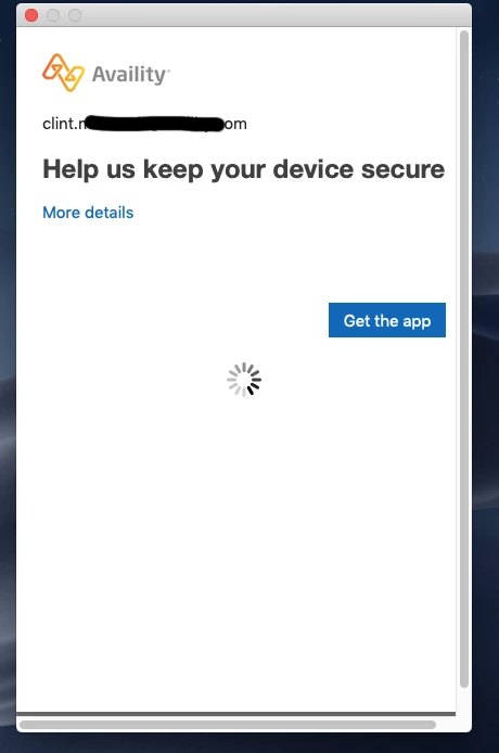

We've followed all the instructions for setting up InTune integration with our Jamf Server on both sides. When I run the self service policy to get a Mac registered in InTune, it goes through all the steps until it gets to the JamfAAD.app where it basically stops. I've let it sit with the spinning gear for an hour with no progress at all. Here's the screenshot:

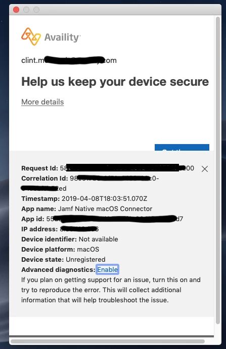

When I click on More Details, here's what it says:
Has anyone else encountered this? What app is it trying to get? Could this window be any more vague?

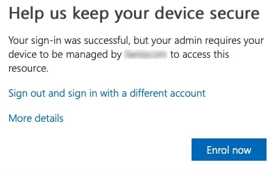

btw does anybody knows if Microsoft supports a "mixed" mode of BYOD Macs (not managed by Jamf) and Jamf managed Macs (with Intune Integration) on the same Intune tenant?
We have both Jamf unmanaged and managed Macs which are registered in Intune and everything works so far. But last week one of our BYOD Macs (which was never managed by Jamf) got a similar Conditional Access message window as above, but with the following text:
And after the user pressed "Enrol now" he was redirected to our Jamf Pro server, which should not happen. But why does Intune get the Jamf URL from the Jamf Connector for a unmanaged (BYOD) Mac?

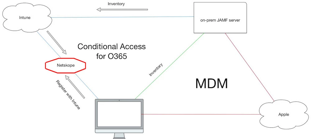

We've made some progress, but are still stuck. We discovered that Netskope is blocking the Macs from registering with Intune. We have proven that if we disable Netskope on our Macs, the registration is successful and works as advertized. Unfortunately, we don't know how to fix it while keeping Netskope installed. Our Netskope administrator has hit a dead end on figuring out how to permit the traffic to flow freely. Has anyone else registered their Macs with Intune while Netskope is installed?
To help our Netskope admin understand the communication between our Macs and the various servers involved, I drew up this Intune Parallelogram. If it's accurate, feel free to use it yourself.

@dmueller Could you elaborate on setting up "an exception for JamfAAD"? Is that an exception in Netskope or somewhere else? To get our setup to work, our Netskope admin essentially had to whitelist every external address that dealt with O365. It turned out that Netskope was getting in the way of a LOT of O365 communications - not just Intune enrollment.
