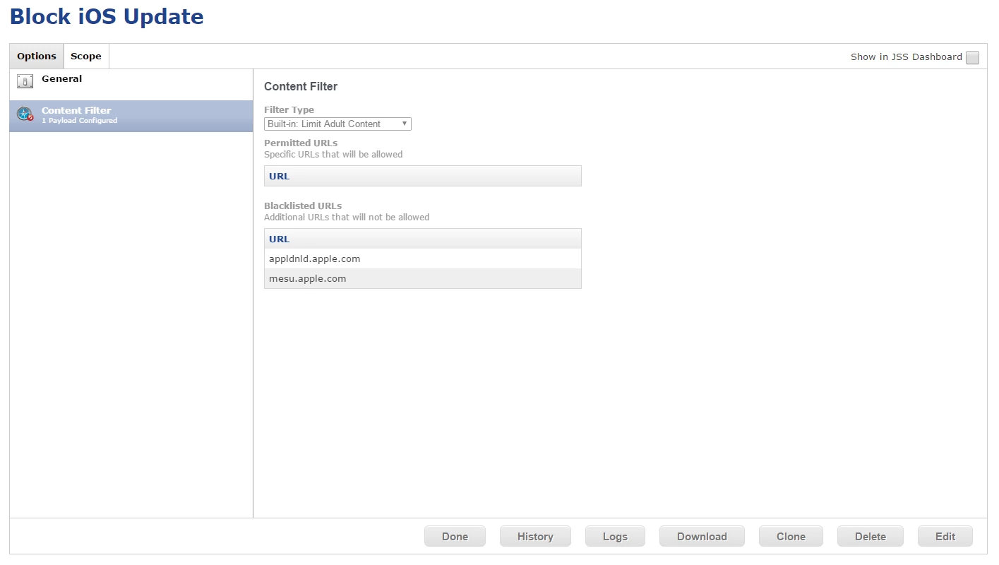

@lbilston I actually decided to block iOS 10 for our users because it was bricking devices and I do not want the network speeds slowed down due to people updating. Assuming your devices are all supervised, I blocked the following sites via a configuration profile (we did this rather than network because devices don't stay on out network at all times) scoped to the users.
appldnld.apple.com
mesu.apple.com
For us, it did not affect updating apps.
Note: Users can bypass network level content filters via a VPN. I am not sure about config files though.
Hopes this helps! Jared :-)

@jared_f , you used the Content Filter options of the configuration profile?
  • September 15, 2016
@cpdecker Yes. We did it both at network level and a content filter configuration on supervised iOS devices. Worked perfectly.
Wow, I was under the impression that the content filter would only apply to Safari-based traffic and wouldn't affect traffic initiated by the OS itself. I will give this a shot and see what results I get. Thank you!
Are these the settings you used? (see screenshot)
  • September 18, 2016
@cpdecker Yes. Did it work for you?
I tried the configuration payload restrictions a few weeks ago and it didn't work.

  • September 19, 2016
@jared_f , unfortunately no it didn't. It blocked access to the URLs via Safari as expected, but the update was still passable.
  • October 13, 2016
@cpdecker I did it both the restrictions profile and network level, I was testing it on the network I blocked it on. Apple needs to find a better solution to allow us MDM admins to block updates.
