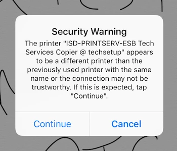

I've been able to get the Printopia printers from profiles to show up outside of the local bonjour range with a configuration profile and by turning off CUPS on my host mac, but I can't print to them unless I'm within the bonjour range. Printopia Pro shows the print job as completed, but nothing actually prints.
This is the message that shows up on the iPad when I move to a different VLAN and try to print:
Security Warning The printer ""ISD-PRINTSERV-ESB Tech Services Copier @ techsetup" appears to be a different printer than the previously used printer with the same name or the connection may not be trustworthy.”

@jbourdon, did you get a response to resolving this issue by any chance with the error message 'The printer '' appears to be a different printer than the previously used printer with the same name or the connection may not be trustworthy. If this is expected, tap "continue"."
  • November 28, 2016
I was given a beta of Printopia Pro from one of their support reps. That resolved the issue—for the most part. When out of the bonjour range the printer is named after the resource path. It works, and if it's the only printer that's coped to the devices it's not that bad...
