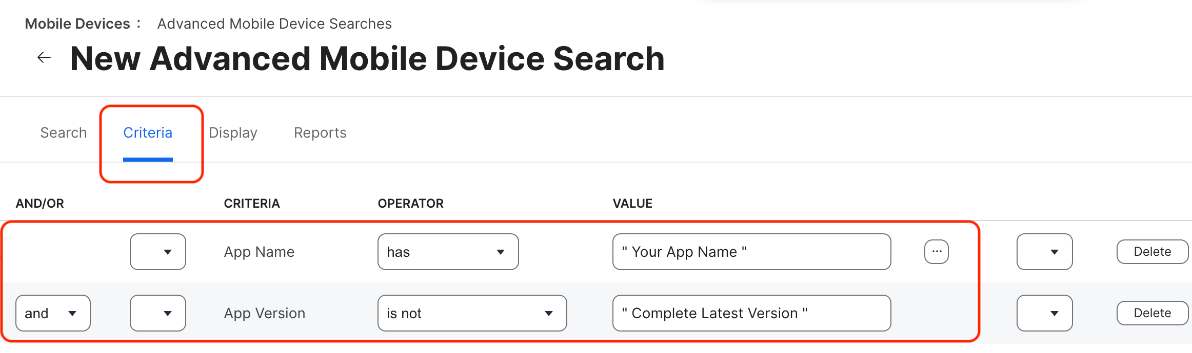

Shyamsundar
  • Jan 24, 2025 7:19 AM UTC
try using the full name of the App and add the version
App Name
App Short Version

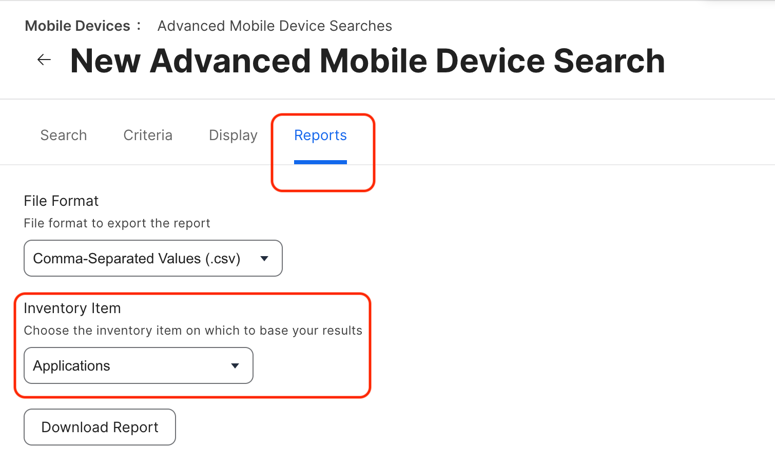

agungsujiwo
  • Jan 24, 2025 8:37 AM UTC
Hi @SteveS
You can try the following advanced search. I have tested it, and it works well.
Change Value
Press Download Report : Generate the Report before Saving
