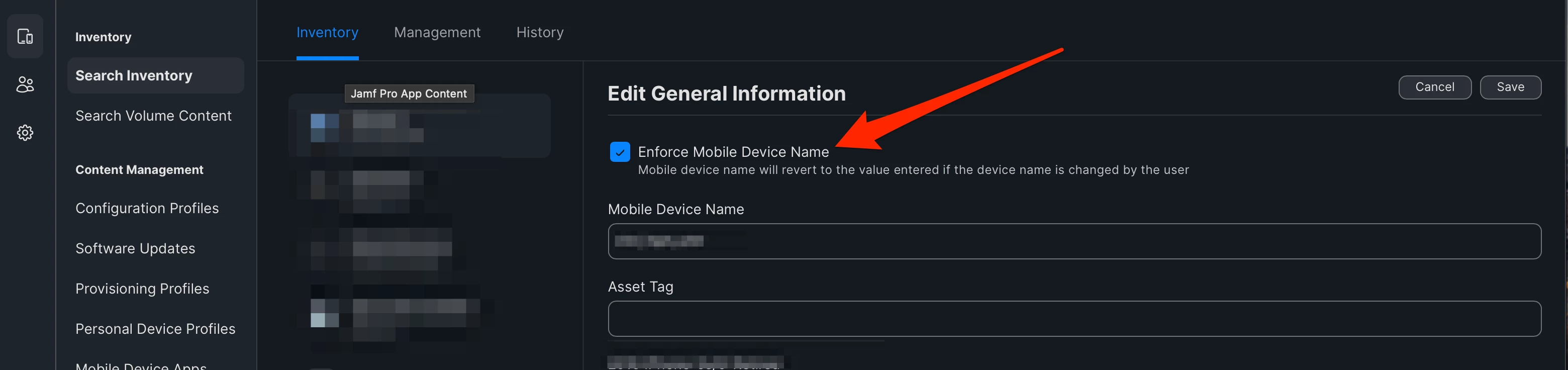

Could look at the device record and see if this box is checked off?

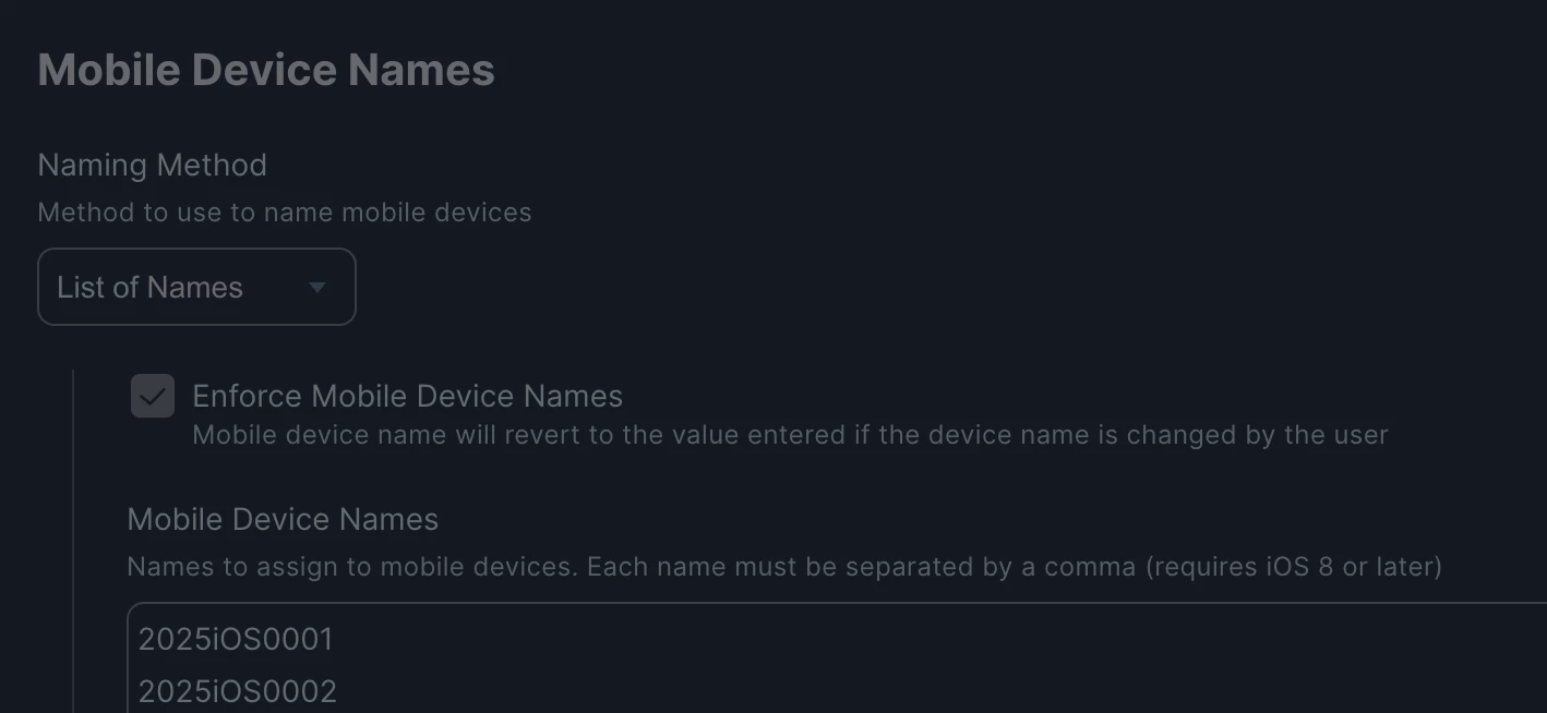

We have it like this:
Its kinda not a bug, its a feature (that told us our jamf guy). Cause after reset, the device will be enrolled again and is just taking a the next name of the list. But we would like that the iOS Device is keeping the name given in the first enrollment.
