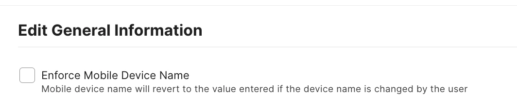

Hi ​@Chubs ,
I’ve experienced the same issue before.
After investigating, I found the root cause was the “ Enforce Mobile Device Name “ setting.
When this option is enabled, if you remove Jamf and then re-enroll with another user, the device name will remain the same as before. You’ll need to disable this setting.

We’ve had this enabled since we have had JAMF and never had an issue until JSS 11.20(.x).
