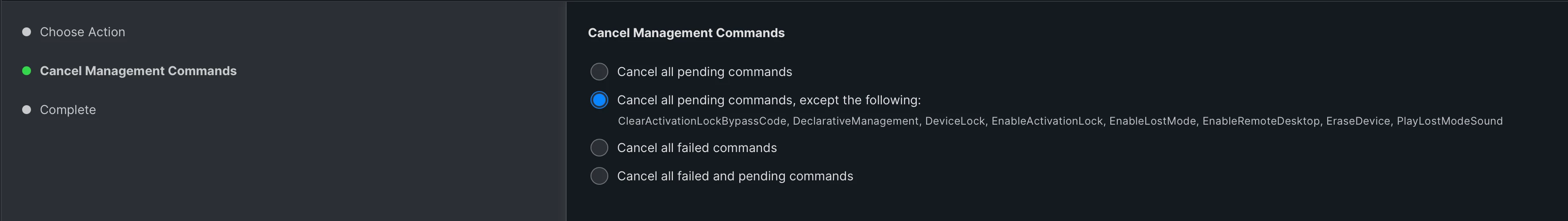

We are attempting to use the mass action to update iPads (~10,000 in batches of 200-300) in our environment, but updates are seemingly being hung up in the pending commands when there are other pending/failed commands.
I've tested on numerous iPads to confirm that clearing out old pending/failed commands (sometimes these are months, or even years, old) and running update inventory allows the update to go through normally.
My question is...is there a way to mass cancel pending/failed commands, but excluding certain commands? I don't see any issues with mass cancelling failed commands, but I am concerned about mass cancelling pending commands where a device may still have an important command pending - Wipe Device, Enable Lost Mode, Unmanage Device - that would be processed when the device checks in.
1 reply
mvu
  • May 13, 2024 12:32 PM UTC
Have you flipped to the new Software update Experience? This would cancel all the in-flight updates.
Also, with one of the recent Jamf Pro updates, included is option to exclude some items...
