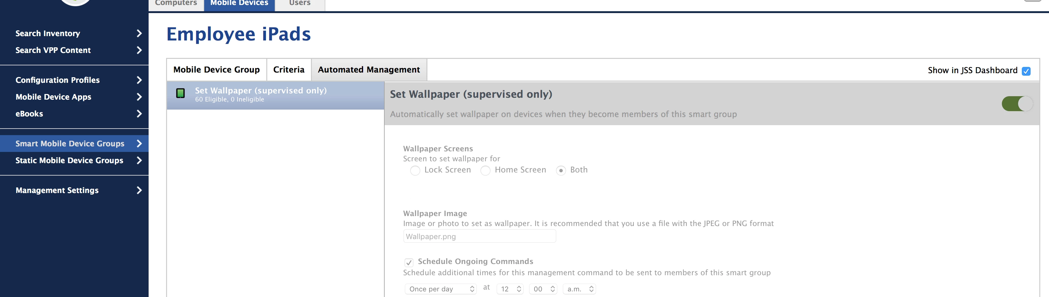

Have you tried setting scheduling ongoing commands? If you go to smart mobile Device group, under automated management. you'll see a radio button with the label "Schedule Ongoing Commands". you can set it so that it sends a command daily at midnight to set the wallpaper. If the user restarts the device and the wallpaper is off centered, the automated management will set the wallpaper again at midnight fixing the problem.
