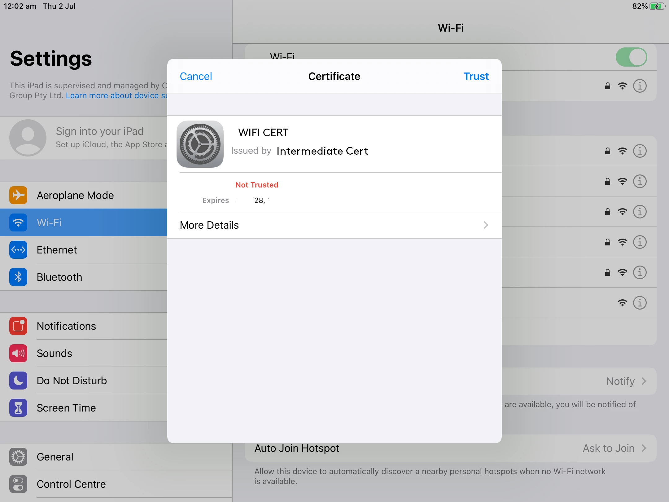

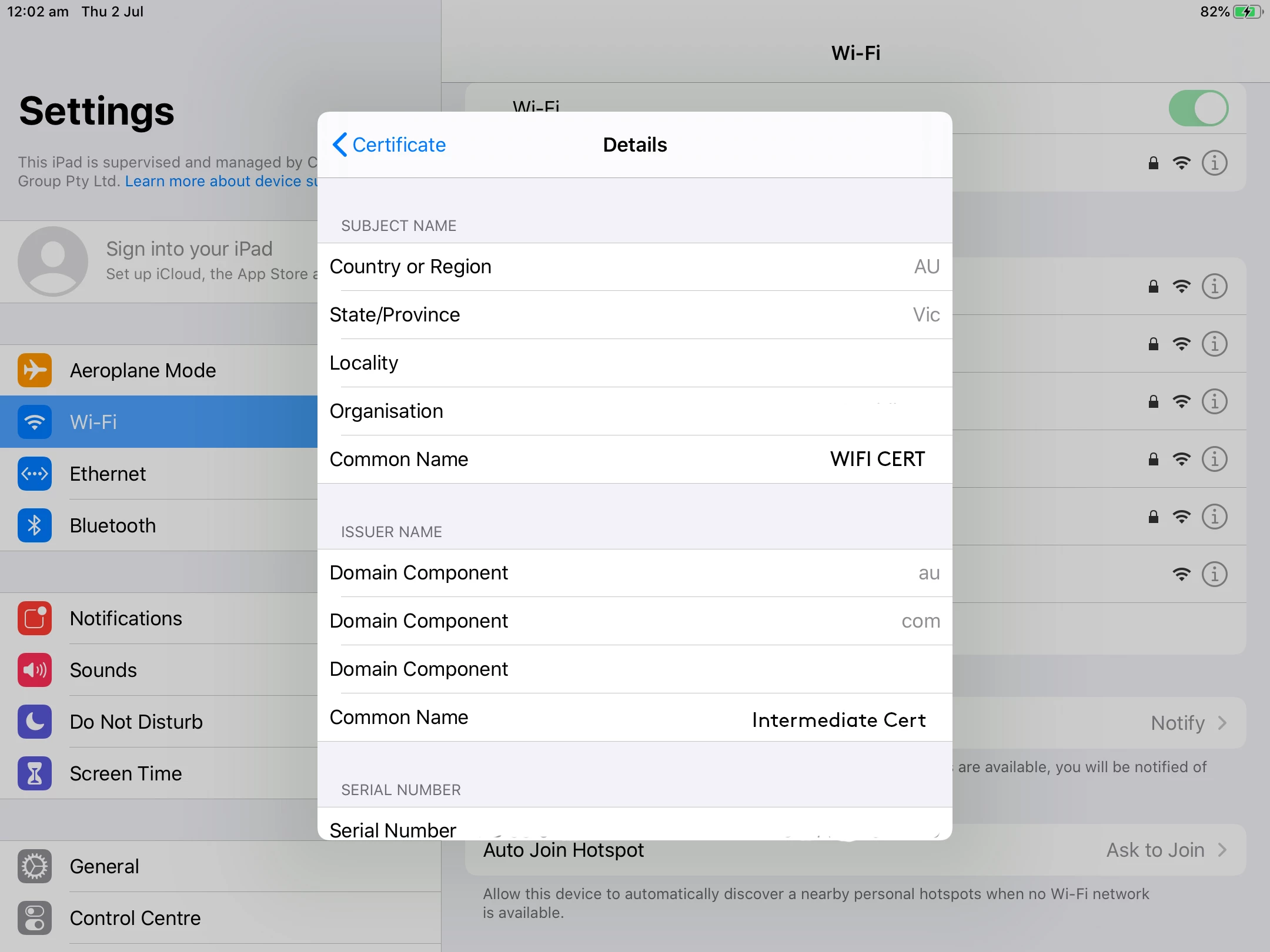

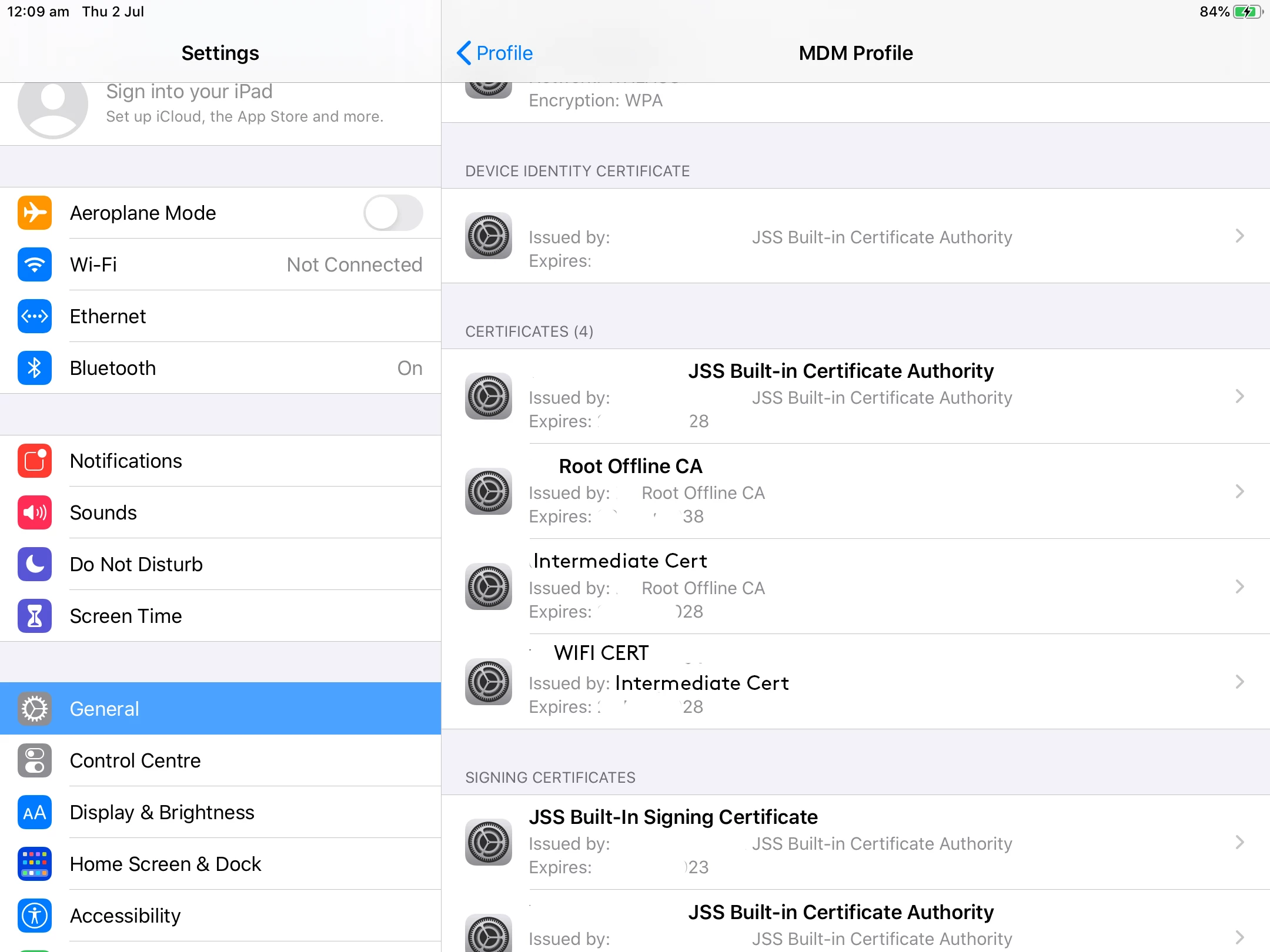

Our iPads do not automatically join one of our Wi-Fi networks because they require the user to select the Wi-Fi and then trust the cert. They are initially setup at Head Office then are sent to a store. But they do not join the Store Wi-Fi automatically on arrival, the user has to go to Wi-Fi settings, click on the SSID under "My networks" then press trust on the certificate.
We have a self-signed root, an intermediate and a Wi-Fi cert. All of which I have pulled directly from ClearPass our Wi-Fi authentication application.
I have put all of these certs into a Config Profile and pushed to the iPads, I have tried in separate profiles and also in the Wi-Fi payload profile but none of these work.
Does anyone have an idea what I am doing wrong here?

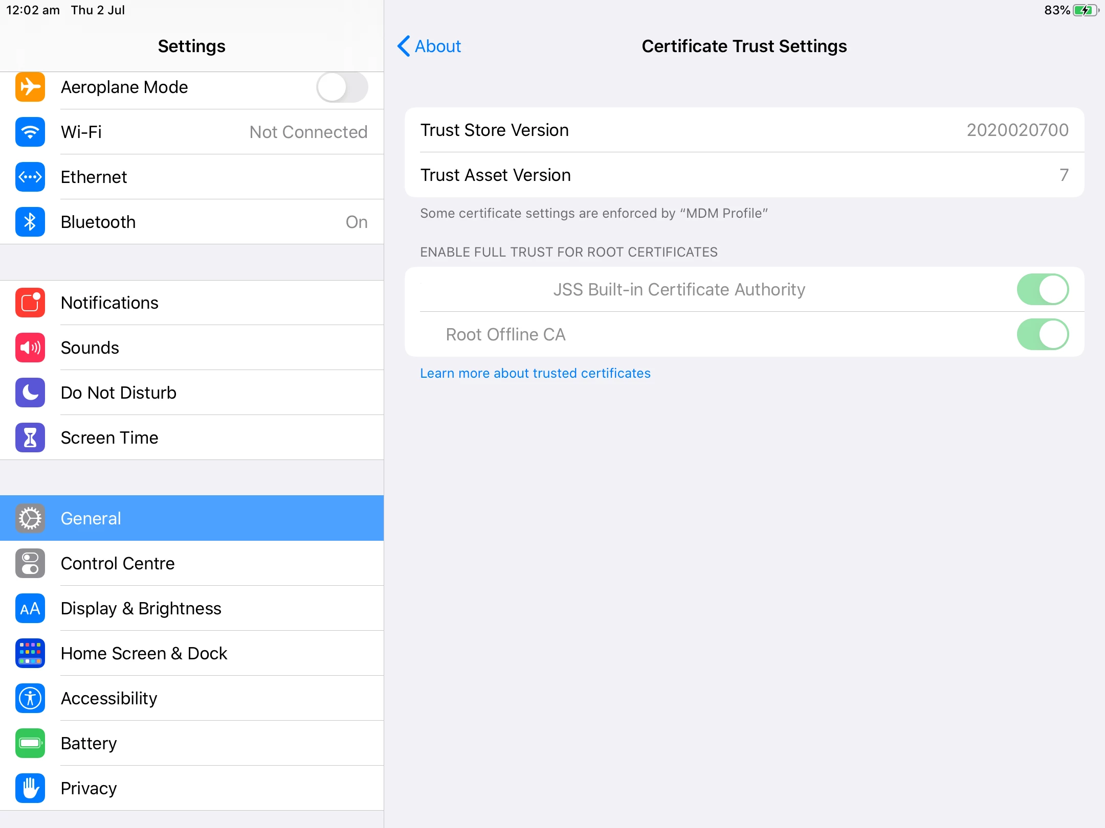

@JosephRecendez Unfortunately not, still struggling with this. I am pushing the CAs, intermediate and WiFi certs via a config profile, they all appear as trusted but no matter what the iPads still prompt to trust the cert when first connecting to our corporate wifi even though it already has the EXACT same cert and all certs in the chain of trust.

I tried messing around with these settings but regardless of the configuration and trust settings it still prompts every time...

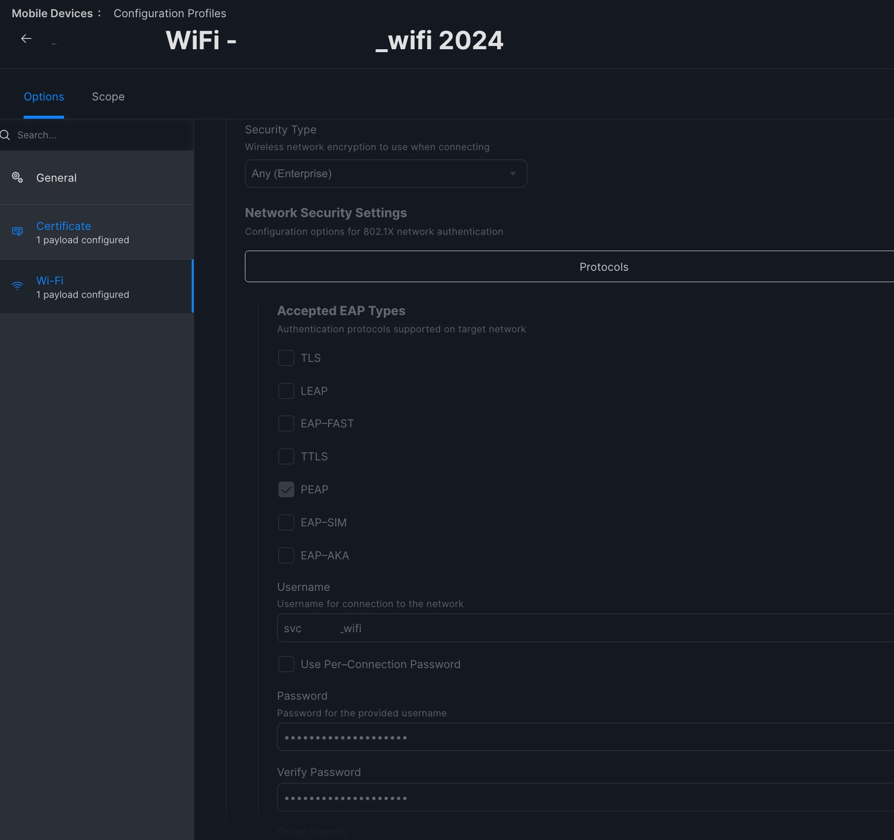

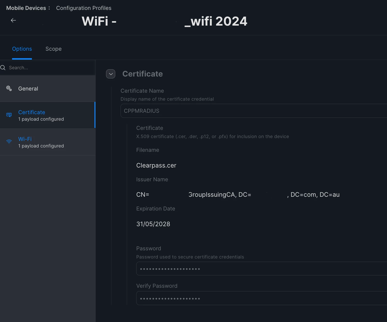

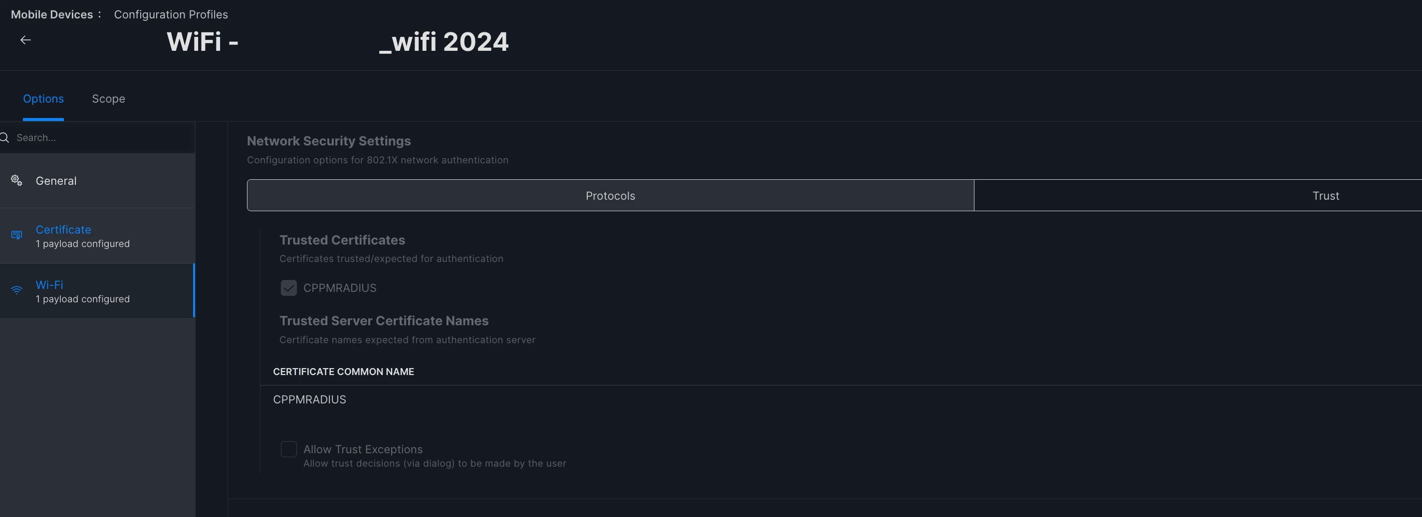

Yeah, we did eventually find a way to have the iPads join an enterprise WiFi Network entirely automatically without the need for the end user to select the WiFi or accept a trust prompt.
I honestly do not know what the change was, it just worked one day. Here's my config profile.

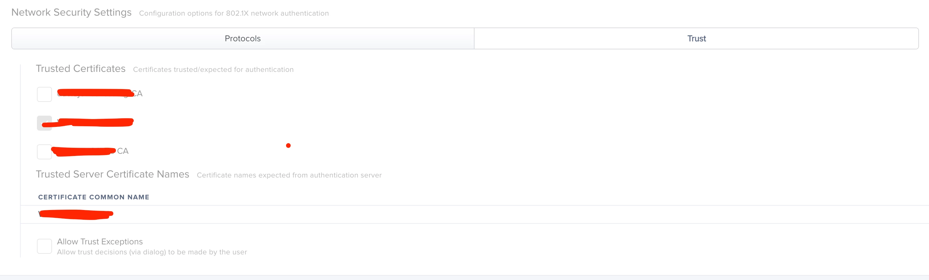

For us it was me not seeing a screen. I had the certificate payload and the WiFi payload in the same profile as required, but I did not see the Trust screen to the right of the Protocols. I had to check the certs to trust them.
