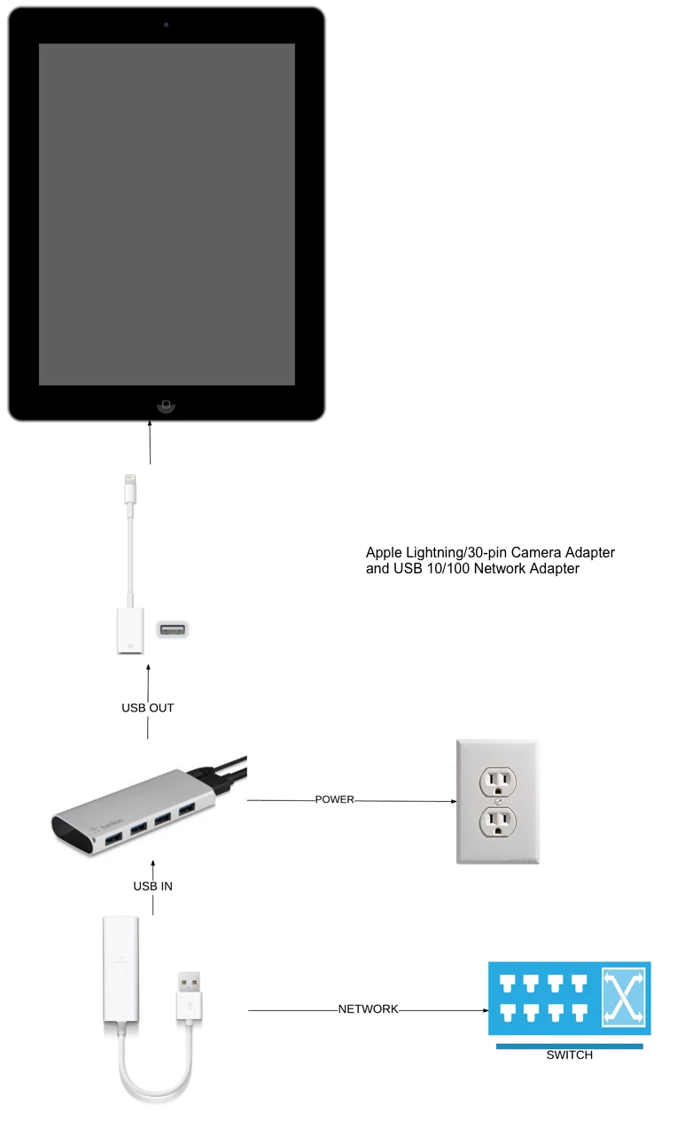

I found this answer in another thread which I can't find at the moment. I copied it down because I think it will come in use at some point for us. You might need to spend some money to get this to work. Basicly, you're tricking the iPad into having an Ethernet connection. I've not done it myself yet but people say it works:
You'll need
Apple Lightning to USB Camera Adapter (Or 30-pin camera adapter if it's an old iPad)
Apple USB Ethernet Adapter
Powered USB 2.0 Hub (any hub but must be powered)
Ethernet Cable
Plug the USB Ethernet Adapter into the USB hub, then plug the hub's cable that would normally goto your computer into the USB Camera Adapter and plug the USB Camera Adapter into your iPad. Plug a network cable into the ethernet adapter, then plug in the power on USB hub. Plug a network cable into the ethernet adapter (the other end plugged into your network of course) and the iPad should pick up that it has a network connection.

Hey All,
I have re-enabled about 15 iPads since November with the exact setup pictured above. (Note: it's not a USB charging hub. It needs to be a USB hub that splits one USB connection into many). The catch is that the USB hub needs to be self-powered with a power adapter. If it draws any power from the iPad at all, it will not work very well. I have found that a larger hub works better than the 4-port hubs because it depends solely on the dedicated power adapter to function.
Once you have the setup connected, go into JSS and send a command to clear the passcode for the particular iPad. It shouldn't take more than a few minutes for the command to get through to the iPad.
There was only one iPad that would not connect, and that one was in airplane mode when it was disabled. I had to wipe and reset that one.
Another thing to note is that the iPad will not show that it has internet connection. I hope this helps a little.
Worked on iPad Air, iOS 9.2.

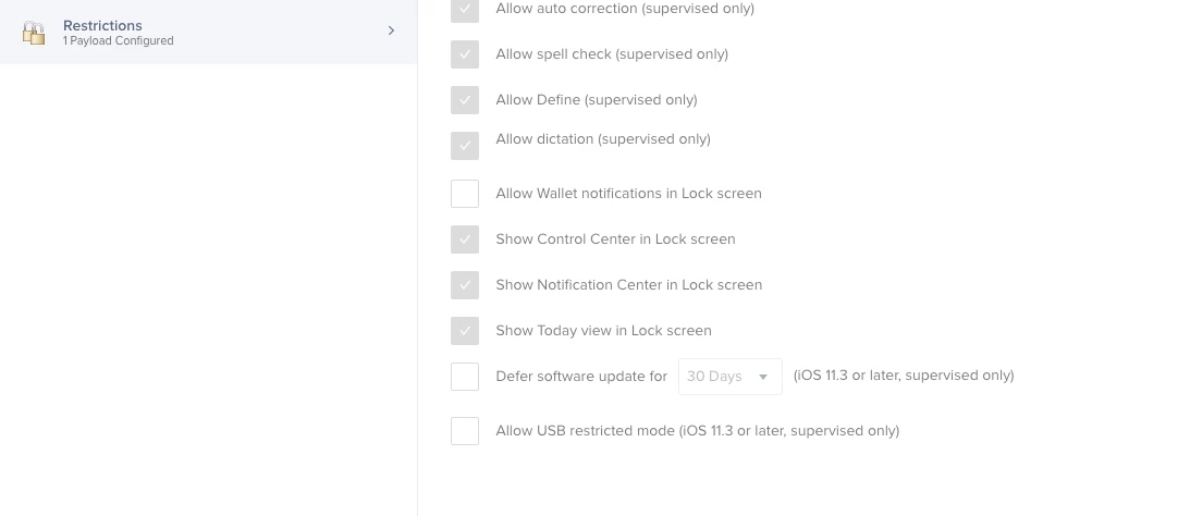

@thejenbot We just purchased the aforementioned RJ45 adapter, but no luck. We've since updated our configs with the "USB restricted mode" restriction. Unfortunately one final student device sacrificed to the DFU beast before we flipped the switch.
