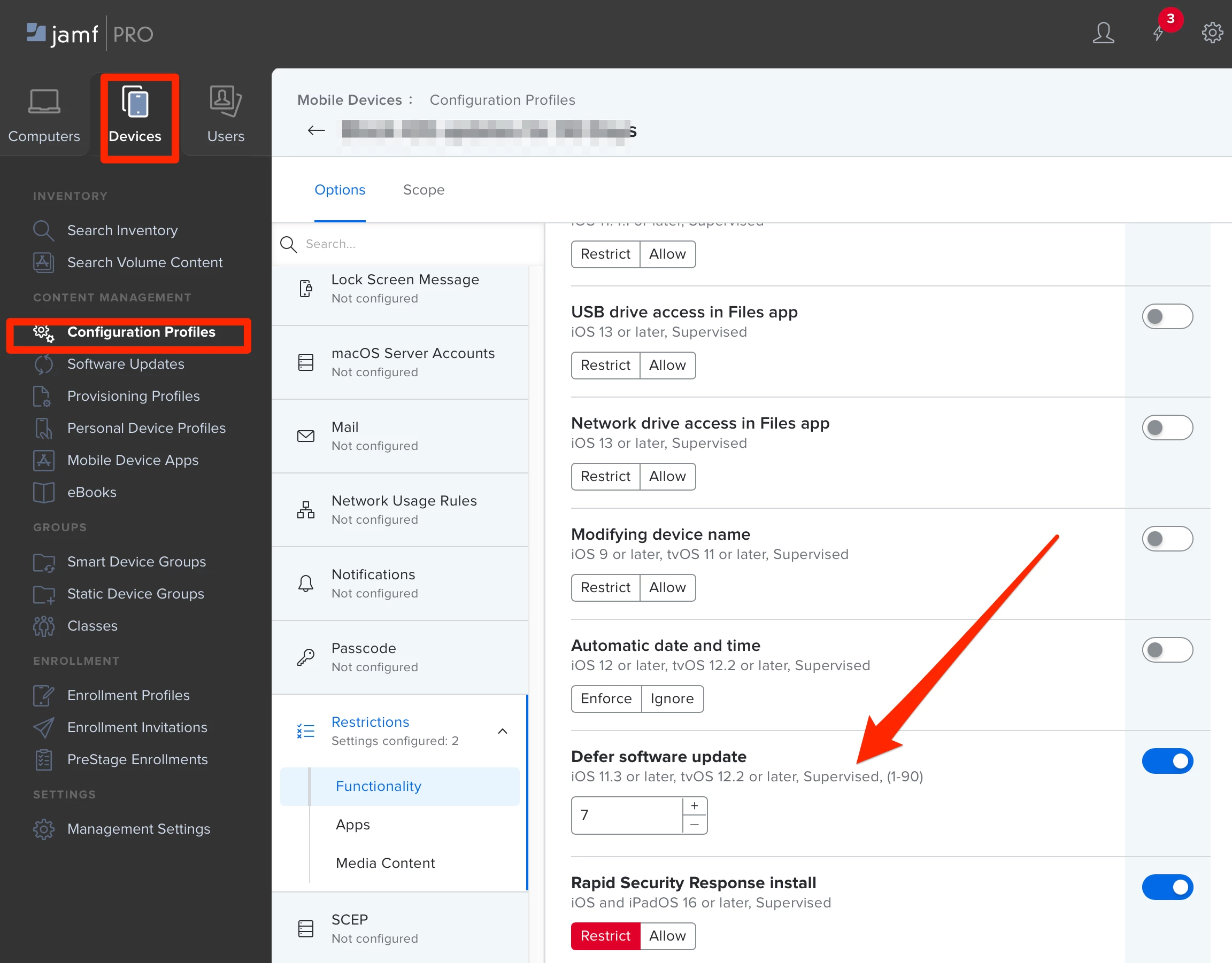

• I would also prep a configuration profile to block the iOS update if you need more time for testing or need to go through a change control process. This way you aren't dependent on asking the user base for action; you're enforcing a deferral. And then you can shift your attention towards the communication of the update whenever you're ready.

What setting in the config profile would block iPadOS updating?

The number you enter the field is how many days you are deferring the update. Test.

Thanks! That's the setting I was thinking but sometimes it's not 100% obvious because of differing language.
We're very sensitive to changes in our management, so we make sure to test as much as we can.

Everything @mvu says here is spot on.  JAMF is usually stellar about supporting new major Apple OS releases on day 1.  So, as long as your JAMF Pro instance is current, you will be able to support iPadOS 17 on day one.  That said, to reiterate his point, you DEFINITELY should be testing with the current iPadOS 17 beta if you are not already doing so.  When the GM candidate releases, that'll be a pretty good metric as to how well you're doing in terms of being ready for it.  Certainly, you can defer your update until a .0.1 or a .1 release if that makes those in your organization feel better about it.  At most, you can defer up to 90 days following the launch.  Though, personally, I'd try to be ready before that point.
