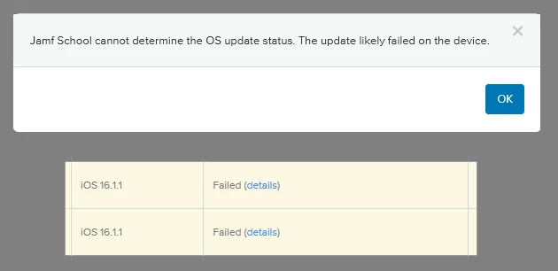

Is anyone able to remotely update iPadOS with Jamf School?
I'm testing a 14.6 -> 16.2 and left it over night to fail.
Jamf School cannot determine the OS update status. The update likely failed on the device.
There is no passcode and it was left plugged in.

The iPad is only seeing 15.7 update in Settings, so it's not even going as far as it could. Maybe that has something to do with it.
I wasn't really happy with the device update experience in Jamf School, just finding the exact serial number and which update it was listed in Jamf School as requesting makes no sense.

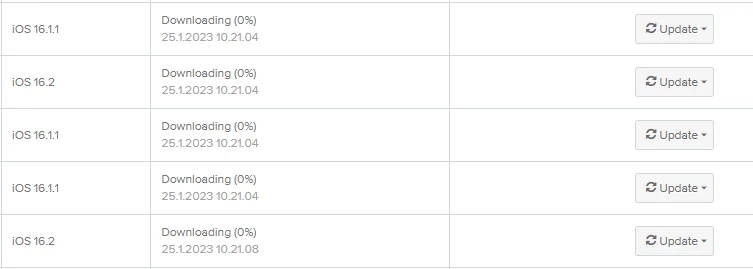

We have 16.2, 16.11, 15.7 and 15.5. I tried to update to 16.3. The update status is 0 %. I waited over night but no success.
  • Jan 31, 2023 8:42 AM UTC
After six days still at 0 %.
  • Feb 3, 2023 6:44 AM UTC
Now the status has changed to failed. Last check-in 5 minutes ago.

It's been that way for over a year where it shows '0%' for both 'Downloading' and 'Installing'.
Though in saying that, I noticed the other day that it now finally shows an actual percentage instead of just 0%.
Was rather annoying over the last year, go to tell 200 iPads to update, they all show 'Downloading (0%)' for a good 30mins, then after a forced-refresh, they'll eventually update to 'Installing (0%)', then after about 10-15mins, they switch over to 'Failed (details)' where it says it can't determine the OS update status, besides already knowing the device is now up to date.
