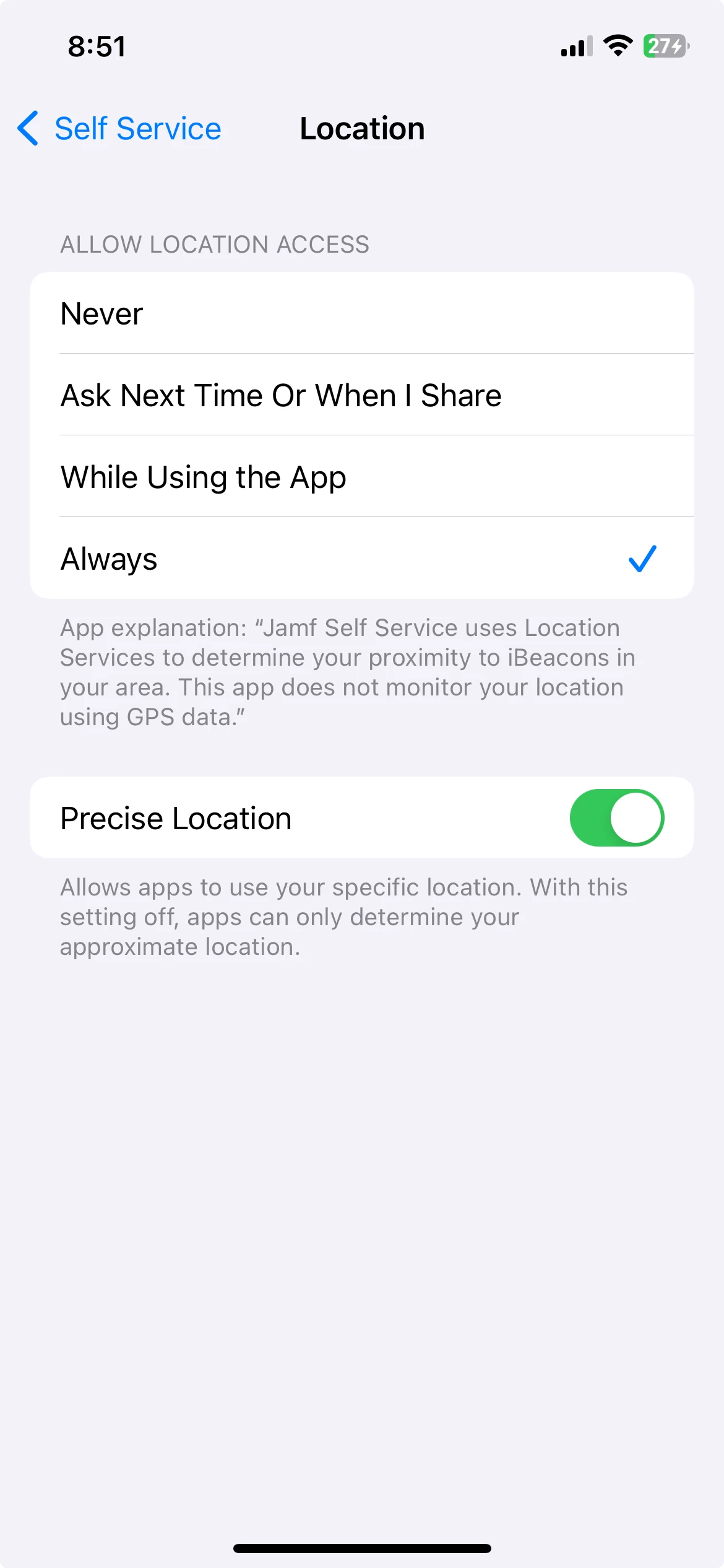

Mine works on an iPhone as well. You can check the Settings app on the iPhone, then scroll down to Self Service to check on Location settings for the app.
 Two things to look for are that an iPhone or iPad have their Locations Services for Self Service set to "Always". If you're turning Location Services on for the first time, I would then quit Self Service and reopen the app so Jamf sends the list of iBeacon regions to the device. I also did an inventory update in Jamf because I'm not sure when it decides to send that iBeacon region file.

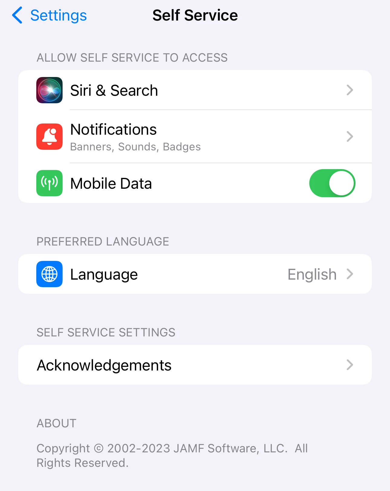

So there are no Location Services available on this version...
Re-downloaded from the App Store today too.

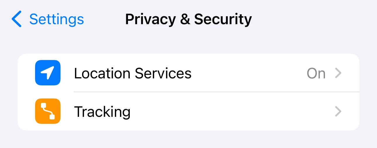

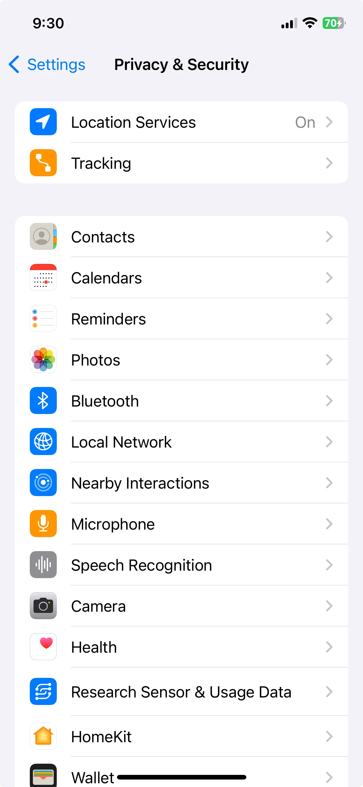

My hunch is you have Locations Services turned off under the Privacy & Security in the Settings app. If that's off then it won't appear under Self Service or other apps.
Nope...

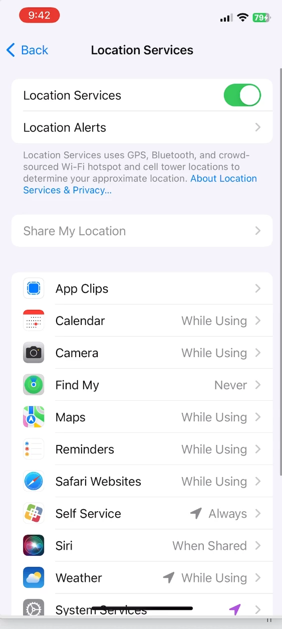

When you tap on the Location Services in the menu you shared, does it show you a list of apps and their location settings like this?
Yep, Self Service isn't there.

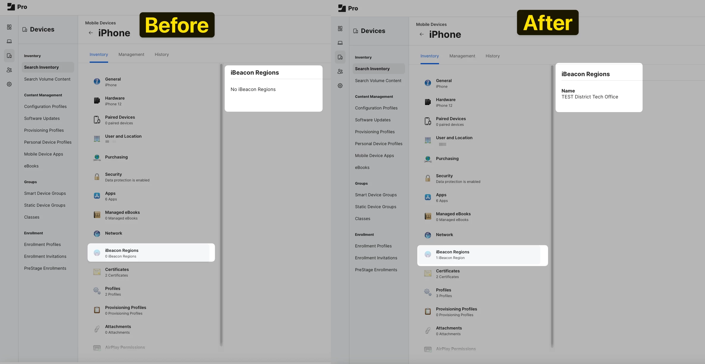

Maybe check in your Jamf Pro setup that inventory monitoring is set to look for iBeacon regions.
