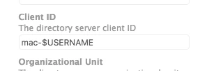

You can set the name in the prestage enrollment settings using the Client ID option, and utilize JSS variables. For instance, we name all our DEP macs: mac-username
That username is pre-popluated based on the user the mac is assigned to in the JSS or what user authenticates in the setup assistant upon first boot.

@ooshnoo I'm new to JSS; could you please describe where is that "Client ID" option in the JSS.
We don't have/ don't use DEP; but I was wondering if there's a "Policie" or a "Configuration Profile" where I can make sure the name of the "laptop" (macbook) it contains the username-mac (so it will be the same settings that you use only backwards "$USERNAME-mac")

@scentsy I am pretty sure he is referencing the directory binding configuration profile payload. So it would use that computer name to bind the machine to AD but I don't think it would actually change the sharing name of the computer. But I could be wrong.

From what I understand you can use have it name to either the computer name (user's macbook), serial number, or UserID using different variables and also a prefix if needed. None of these work in our environment (like others) as we have standard naming conventions and continuing with that process is desired.
I understand a lot of this depends on Apple what all can be done through DEP. What I fail to understand though (have tried talking to JAMF numerous times about this) is why this can't still be resolved by JAMF.
If you are able to have some control over how the machine is named (ClientID Field) why can't that field be used to reference some unique feature of the machine (serial number / mac address) to some external source to obtain the ID to computer name matching? So when you receive machines you build the associations in a DB or JSS and when the machine is enrolled JSS looks up the mapping and places it essentially into the ClientID field the computer uses to find out what it should be named. Almost like building a dynamic PreStage for each machine you enroll. It seems like that would be one way to work around Apple not making this feature a part of their DEP.
