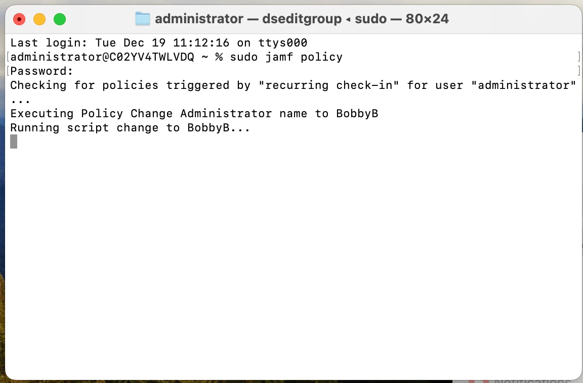

2. Running sufo jamf policy I can see the script is trying to run. After waiting an hour it still won't run. The policy is called BobbyB. Any ideas why it won't execute?

This is the error I get when trying to add the log from sudo jamf policy
Your post has been changed because invalid HTML was found in the message body. The invalid HTML has been removed. Please review the message and submit the message when you are satisfied.
  • Dec 20, 2023 1:59 AM UTC
lets tidy up
#!/bin/bash #Variables current_admin="Administrator" new_admin="Robert" if id "$new_admin" &>/dev/null; then echo "Username already exist." exit 1 else if id "$current_admin" &>/dev/null; then sudo dscl . -change "/Users/$current_admin" RecordName "$current_admin" "$new_admin" sudo mv "/Users/$current_admin" "/Users/$new_admin" sudo dscl . -change "/Users/$new_admin" NFSHomeDirectory "/Users/$current_admin" "/Users/$new_admin" sudo /usr/bin/dscl . -append /Groups/admin GroupMembership "$new_admin" echo "Admin username is changed." exit 0 else echo "Coult not find admin account" exit 1 fi fi
Executing Policy Change Administrator name to BobbyB 3
Running script BobbyB 3...
Script exit code: 0
Script result: <main> attribute status: eDSAttributeNotFound
<dscl_cmd> DS Error: -14134 (eDSAttributeNotFound)
mv: rename /Users/Administrator to /Users/Robert/Administrator: Operation not permitted
<dscl_cmd> DS Error: -14009 (eDSUnknownNodeName)
change: Invalid Path

Finally found a way to get the error message to you. So we are close and the name was not changed as it stated. Not sure what is causing the error.
