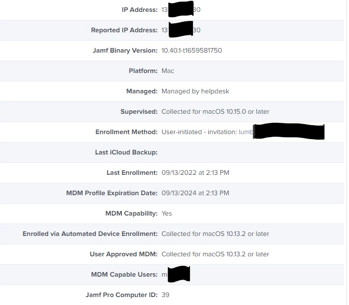

I am fairly new to JAMF Pro and have had mostly good results.  My new devices auto enroll fine and get all required policies.  Most of my older devices have also been fine when completely reloading them before enrolling.  I am however having some issues with devices that are in the wild getting policies after I enroll.
So I have been visiting offices and manually installing the enrollment profile on devices that used to be enrolled in our Mac Server MDM instead.  While the profile installs fine and it auto pulls the MDM profile and another, the rest of my JAMF configs in at least 1 case haven't installed after 12 hours and multiple reboots and terminal command sends.  Looking in JAMF pro the devices still shows just basic enrollment but no group memberships or config profiles and policies for the device (but  the device HAS been added to several static groups).

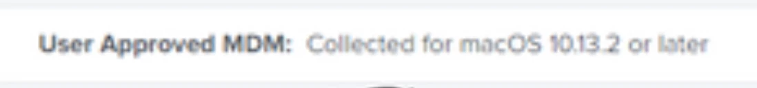

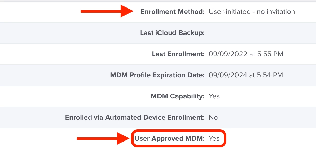

As you are manually installing enrollment profile, that's means you are initiating User-Initiated Enrollment. First Step of troubleshooting should be to check if User Approved MDM (APMDM) is Approved. Please refer screenshot for the same.

User initiated.  I'm the user installing on the end user device.  It seems enabled.  It gets the initial 3 profiles but none of the device specific profiles, policies, groups, etc...

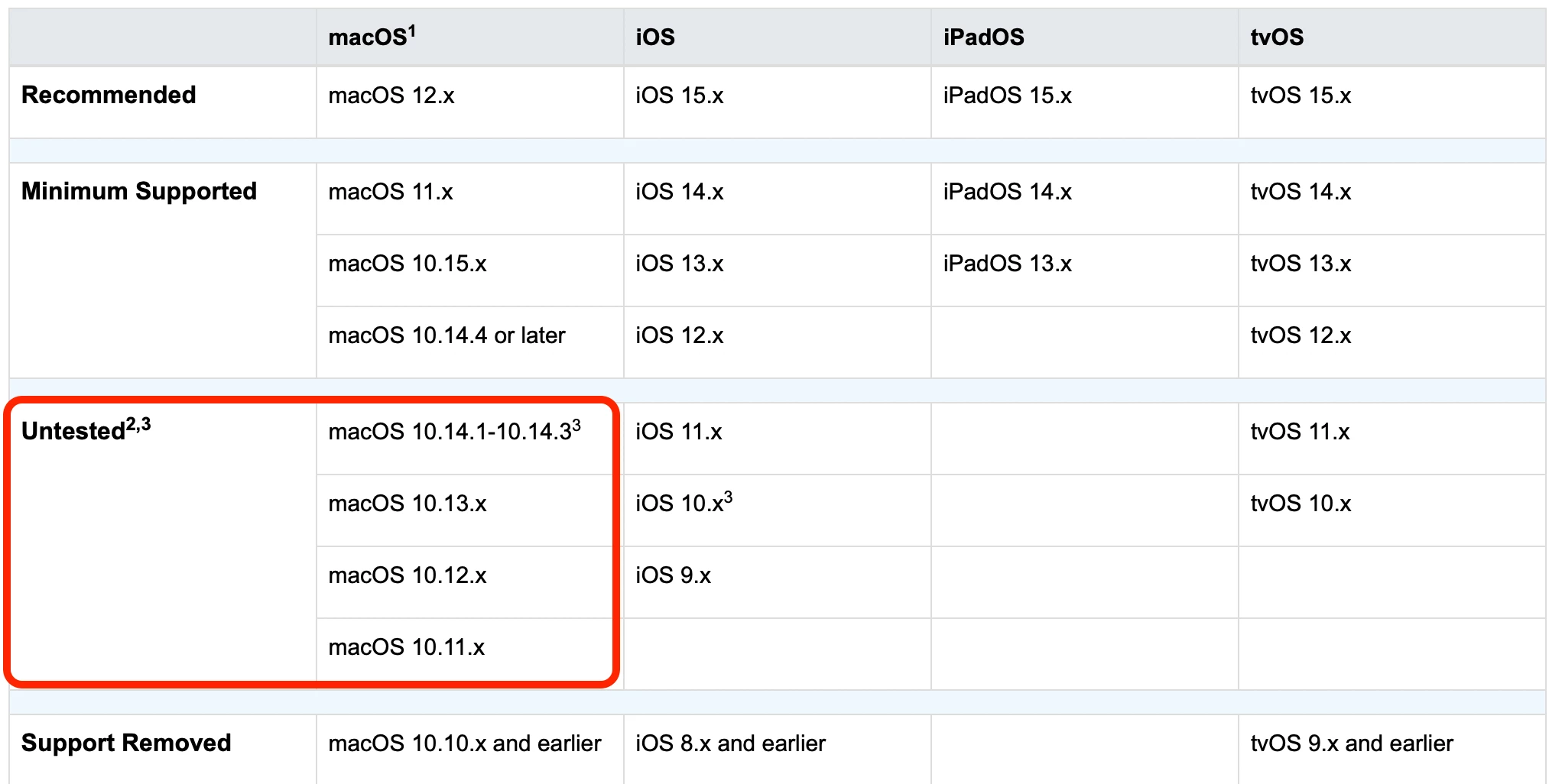

I see an issue in the operating system version of device mention in the screenshot. the macOS is lower than 10.13.2. Man thats a security risk. I recommend testing enrolment on latest macOS version
You are on Jamf binary 10.40.1 and below is the Apple macOS Compatibility with this Jamf Binary and macOS 10.13.x is untested.
