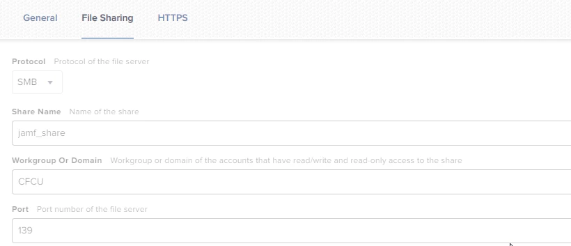

Since I migrated Jamf to a Windows 2019 server two weeks ago, I have been troubleshooting the primary distribution point. The distribution point and jamf server are running on the same VM. I have tried and failed with https, probably because of the same root cause... so I am trying to simplify the issue by first troubleshooting the SMB dist point problem.
I am able to mount the share both from Windows and Mac clients using the jamf service accounts. I have been able to validate that the accounts work as-should... one read-only, the other read-write. I don't know what the jamf binary and jamf admin do differently to mount the distribution point, but both fail without any helpful messages.

I'll update this and mark it solved later this week after testing some more scenarios. What I found just now, which is weird because it was not setup this way on the old server... everything works when I use the legacy short domain name
This was the resolution... I need to take a look into why this is the case... but maybe this will help someone in the future.

I fixed this by removing the domain suffix from our domain name in the SMB distribution point settings, and just used the simple AD name for the domain, e.g.: pretendco instead of pretendco.com .  This started to be an issue in Monterey, though I'm not sure why.
