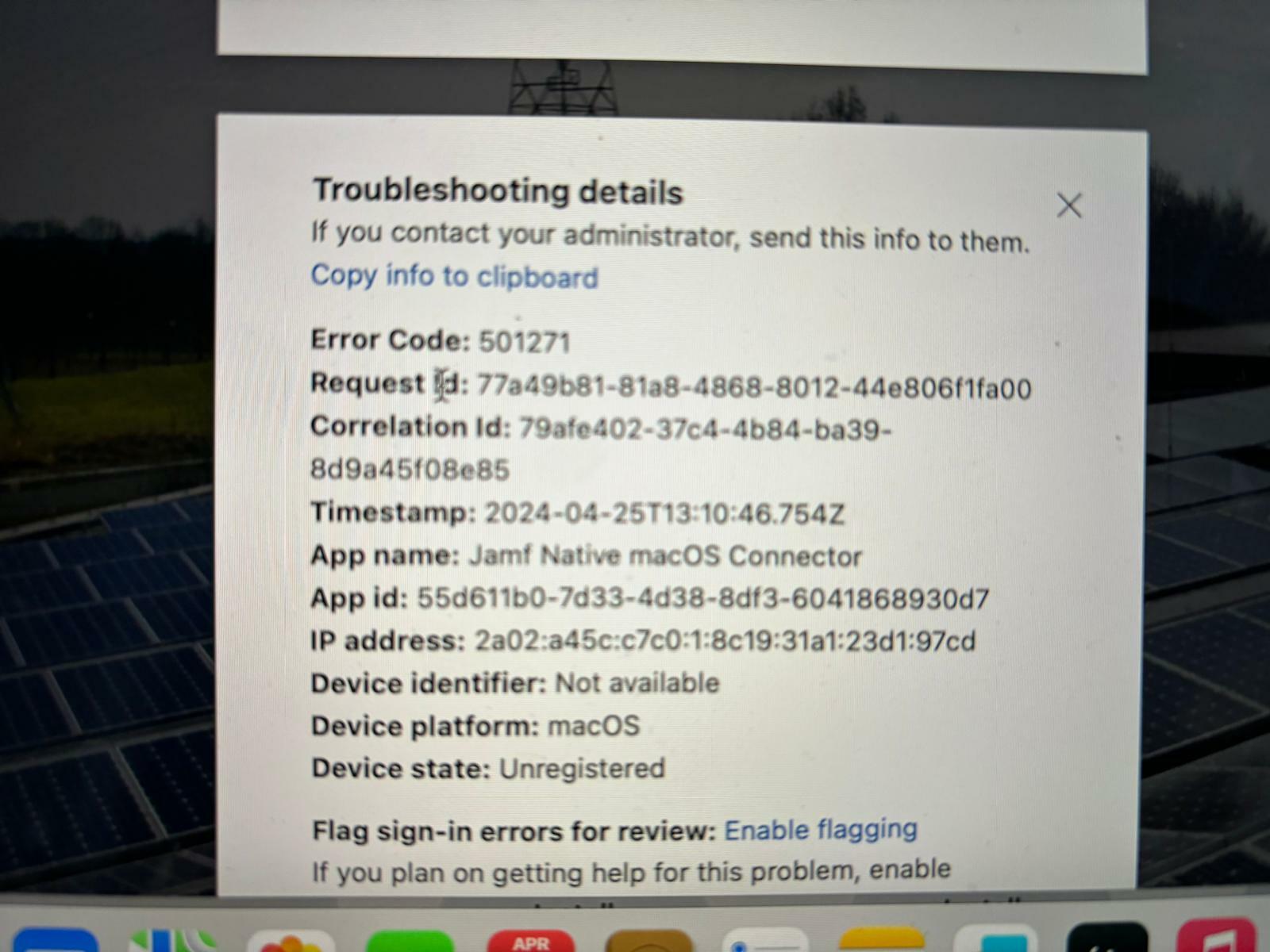

We use Jamf Pro and have an integration with Conditional Access to register Macbooks within Microsoft Intune.
We have recently started receiving this error message and have not been able to resolve it. Who can help me think about how we can tackle this issue?

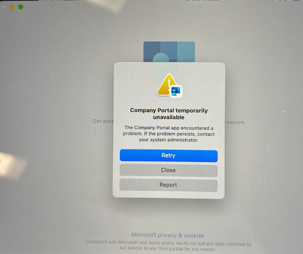

Its a problem with the Comp Portal App, I would suggest starting with following Microsoft troubleshooting doc linked below. This specific error is something to do with the broker function of the Comp Portal. However, for the love of God skip the first two steps of removing the MDM profile and Jamf framework, I'm not sure what clown put that in there.
Troubleshooting Jamf Pro integration with Microsoft Intune - Intune | Microsoft Learn

In Azure AD we got the following message:
Failure reason
Broker app needs to be installed for device authentication to succeed.
  • May 14, 2024 12:39 PM UTC
I have the same issue
Failure "Broker app needs to be installed for device authentication to succeed."
Error code: 501271
It works for me in Poland after this command typed in terminal "defaults write com.jamf.management.jamfAAD useWKWebView -bool true"
However for other locations company portal is just crashing with error and i have the same error code on intune side.
Conditional access policy is set to report only so it cannot block anything.
In case you have a solution for this please share it here.

If you are stuck on this error, try an older version of company portal if you’ve have a previous version prior to the one giving you a headache (Currently having issues with Version: 5.2604.1 (53.2605002.000)
After sometime looking up the issue seems to comeback through the years with MS/Apple changes, for the meantime we’ve reverted to deploying version 524091 during user initial setup. Once Entra registration is complete, and com.jamf.adcsintegration.privatekey is in keychain updating to the latest has not caused any issues. This is just a work around since surely the older version will go out of service, platform SSO is what we’ve been looking into next.

I have now received the following reply from Jamf Support:
It sounds like there may not be an SSO extension profile in place on the computer which is now required:
https://community.jamf.com/tech-thoughts-180/upcoming-change-device-compliance-integration-for-macos-sso-extension-required-53476
Microsoft has a good doc on the steps to create this in Jamf:
https://learn.microsoft.com/en-us/intune/device-configuration/templates/configure-enterprise-sso-plugin-macos?tabs=prereq-jamf-pro%2Ccreate-profile-jamf-pro#create-a-single-sign-on-app-extension-configuration-polic
In the meantime, if there are any other questions, concerns, or updates related to this case, please reply to this email and we'd be more than happy to assist you!

We had the same instructions given last week when first working on the issue. However it was unstable in fixing the problem , at least for our environment. It worked for one machine in the fleet, and was unable to replicate across other devices M1-5. Will try retesting to see if anything changed
Still no dice with this setup, hopefully they do not depreciate older install pkgs in the meantime
