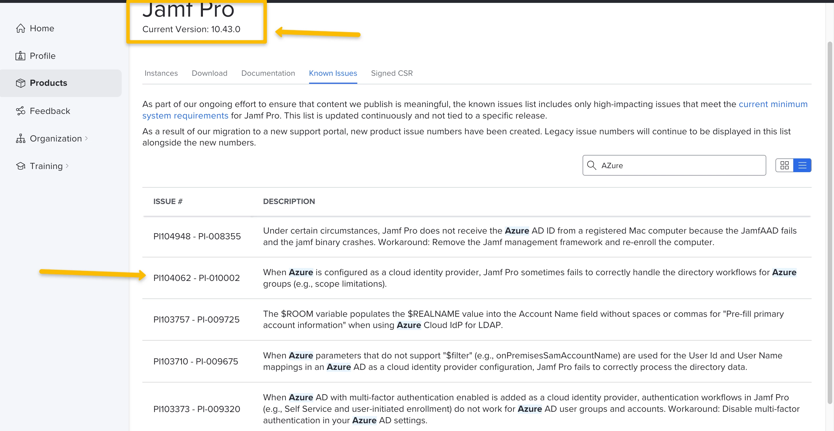

Best answer by colorenz
Oh i found a PI, maybe you have that problem...
https://account.jamf.com/products/jamf-pro/known-issues
PI-010002
When Azure is configured as a cloud identity provider, Jamf Pro sometimes fails to correctly handle the directory workflows for Azure groups (e.g., scope limitations).

  • Dec 10, 2021 10:13 PM UTC
PI-010002
  • Dec 10, 2021 10:21 PM UTC
indeed it appears to be exactly the same symptom.
Well, we just have to hope that Jamf fixes this problem in the next releases.
