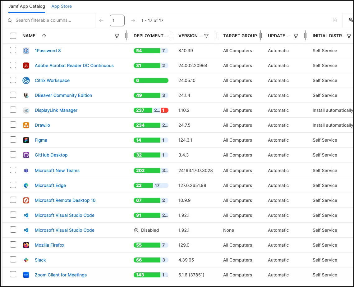

Only deploy Adobe Reader via JAMF Apps.. we have many many other apps all managed with JAMF Apps with deployed automatically and via Self Service. We have zero issues.
more chunky Adobe apps.. I'd be inclined to use the old tried and trusted method.. of pkg deploy / scripting.

Jamf apps has been running well since the Cloud server update of around ~11.70.  When they first pushed it out you couIdn't reinstall an app! I get notifications that app updates are in progress. Mostly all apps we deploy are Jamf apps.  The only Mac app we have is FileZilla and is in Self Service.
Ok thanks. ill keep playing with it then. Perhaps its a waiting thing as i only did scope these this am. was excited about not having to make pkgs anymore...
EDIT: went to look at the test machine, and even though the report says 0 deployed, it does have all the applications now! So i can confirm that even with the thick adobe ones, it does seem to be working!

our wait time is about 20mins max, but there are a number of factors here. .. tail -f /var/log/install.log and you can see the MDM app install. There is a bit of a delay in the UI.. and there is no 'recon' going on.. add Patch Management for each Adobe app, then add a smart group with 'patch reporting version - is not latest' and you can track this.
