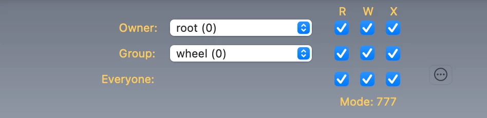

Best answer by Lion55
​@Chubs / ​@ktrojano I have work out this issue with Techsmith the permisson need to be set as 777 as shown in the screenshot:
thanks for the support ​@Chubs / ​@ktrojano

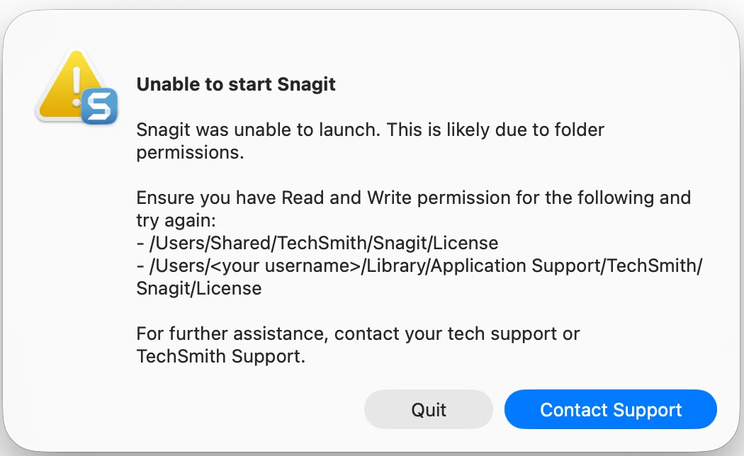

  • Jan 6, 2026 10:38 AM UTC
​@ktrojano / ​@Chubs : you can create the file path in Jamf composer for licenses as an PKG, but it doesn’t work when upgrading the app? any thought on my error message attached?

Should be able to do a one liner script in files and processes under a Policy to add the license file. Something like this:
mkdir -p /Users/Shared/TechSmith/Snagit && echo "12345678910" > /Users/Shared/TechSmith/Snagit/LicenseKey
**Do not add a file extension to the file. Snagit doesn’t like that.
  • Jan 8, 2026 9:23 AM UTC
P.S. ​@Chubs the old application is still working 😉

  • Jan 8, 2026 2:59 PM UTC
Yep - permissions will get you every time.  I also don’t use composer because of things like that.  I’d recommend using a script to set this as it’s much more dynamic.
