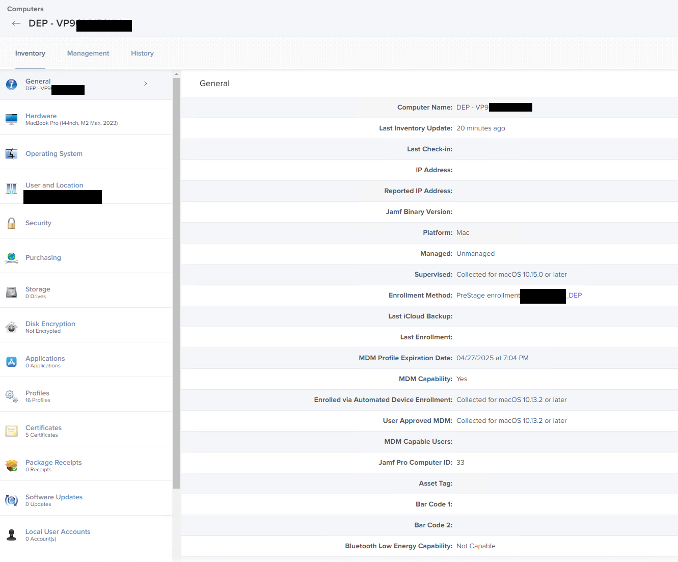

Not sure what's going on but I've setup the JAMF DEP automated enrollment.
I've been able to successfully enroll 20+ macs in the last week, but all of the sudden today, my device is not enrolling correctly.
All devices that are being enrolled are showing "Unmanaged" and the JAMF binary is missing from the /usr/local/JAMF folder is missing.
Oddly enough though, the base MDM profiles are coming down as well as JAMF Connect package.

@atomczynski11 - tried sudo jamf update // manage // policy.
unfortunately all three return sudo: jamf: command not found.
The entire binary never came down, so none of the jamf commands will work.
/usr/local/jamf is a missing directory.

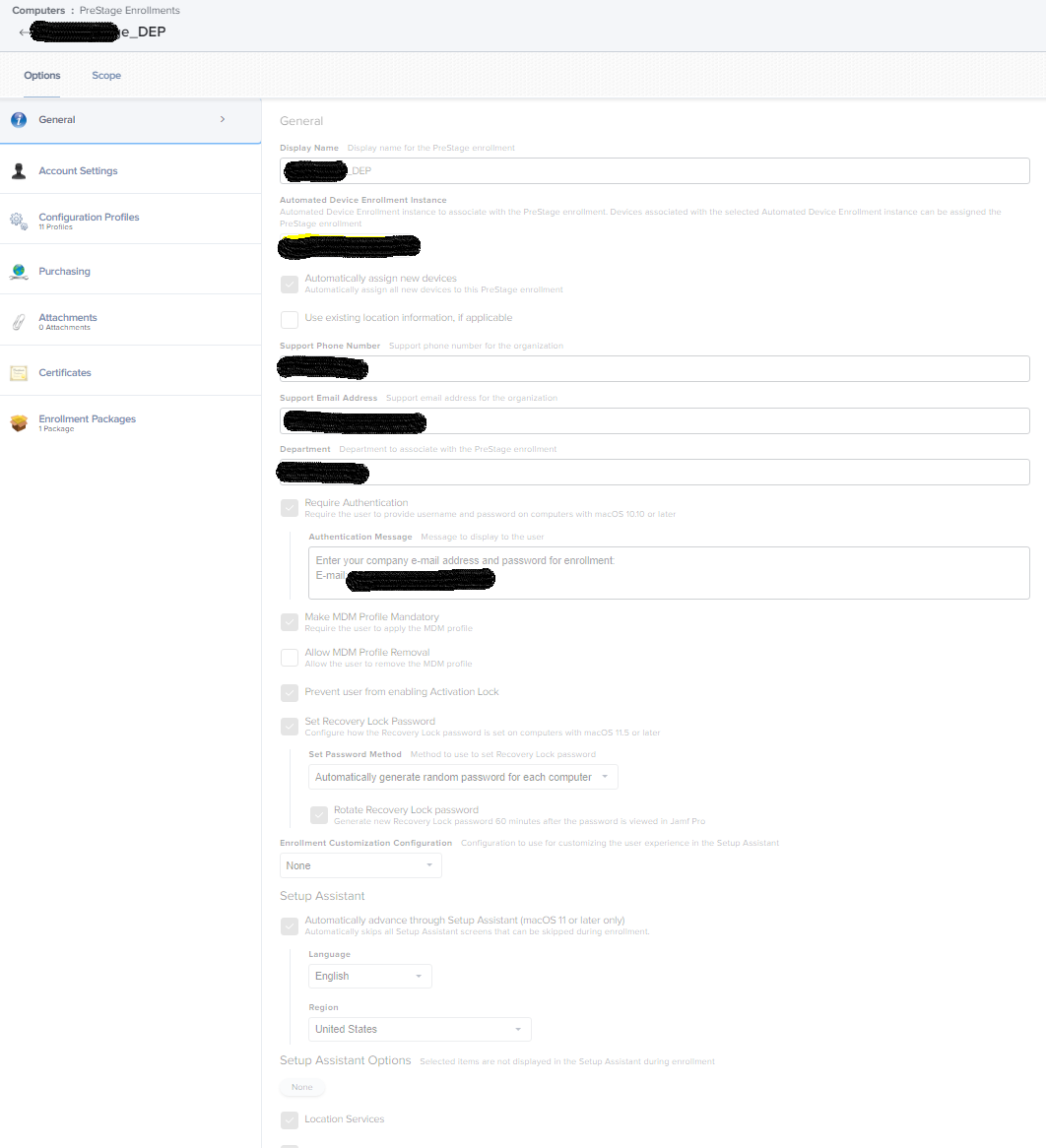

Same issue with DEP Enrollment here too - tried all of the "fixes" i'd seen, but there is NO jamf binary being installed: **this has been since I updated to 10.46**
Location Services and Migrate Data panes not skipped in Setup Assistant
Manually selecting the manage option - saving - then wiping and re enrolling
Instead of using the built in macOS "Erase and Restore" - Using Recovery for a total wipe and restore
Toggling Hide Administrator account on and off
currently waiting to hear back from support

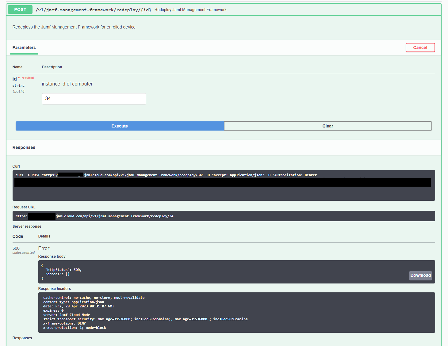

Additionally i've attempted to run the API call for redeploying the framework, still failed.

I am seeing this EXACT issue today. I have a project to remove my legacy User-Inititated (AKA 'Jamf Management') admin account and only use a PreStage admin acount. This was approved by Jamf support in a support case that I opened for this sole purpose. Once I was 'blessed', Here's what I did:
1 Disabled the User-Inititated admin in my JSS admin console (10.46.1 on-prem).
2 Updated my PreStage admin account creds - saved & synced to Apple.
Booted several freshly-wiped DEP/AMB enrolled Macs. Saw the familiar "Remote management" screen (gear icon) and continued...
Once logged in with my PreStage account creds, I realized the Jamf binary wasn't installed (and my subsequent DEPNotify workflow and associated polciies couldnt run). A computer record was never created in Jamf. The Mac was in "Limbo".
Tested this on both Mac laptops and desktops and on both Monetery and Ventura, including ARM and Intel Macs. I used both native Ethernet (iMac) as well as USB-A and USB-C Ethernet dongles. All of them had the same results. Fail.
Once I re-created a dummy User-Inititated admin account, everything was back to 'normal' and I was able to enroll/deploy all my test Macs as expected.
