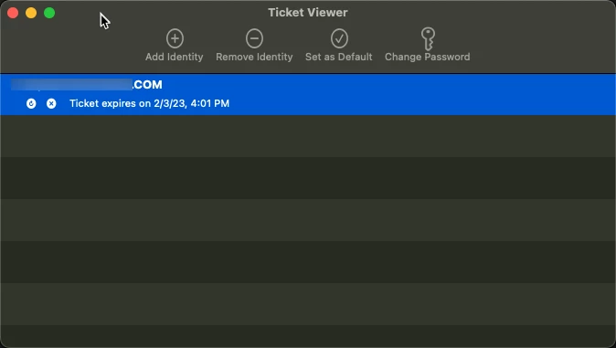

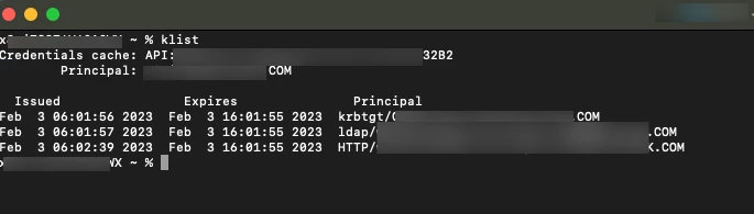

This sounds like its working as intended. When you demobilize an account you break its relation with Active Directory. So when you tell macOS to check the Accounts AD groups, there is no AD object linked to the account for macOS to check.
MacOS does not give two poops about a users AD Group memberships. So the Mac not knowing your AD groups does not matter as it does not use AD groups. JAMF Connect does create a kerberos tickets which can be used to tell network services who the user is. You can also configure SSO Apps like Microsofts Comp Portal, Okta Verify, and so on to identify the user.
I recommend focusing on checking the kerberos tickets.
As far as the password sync. That will never be automatic unless the user uses JAMF Connect to Change their password. JAMF Connect will update AD with the new password, and update the macOS Keychain with the new password. If the password change comes from anywhere other than JAMF Connect, the user will need to enter the new password in to JAMF Connect which will cause JAMF Connect to "reconnect" with Azure, and then update the keychain password.
