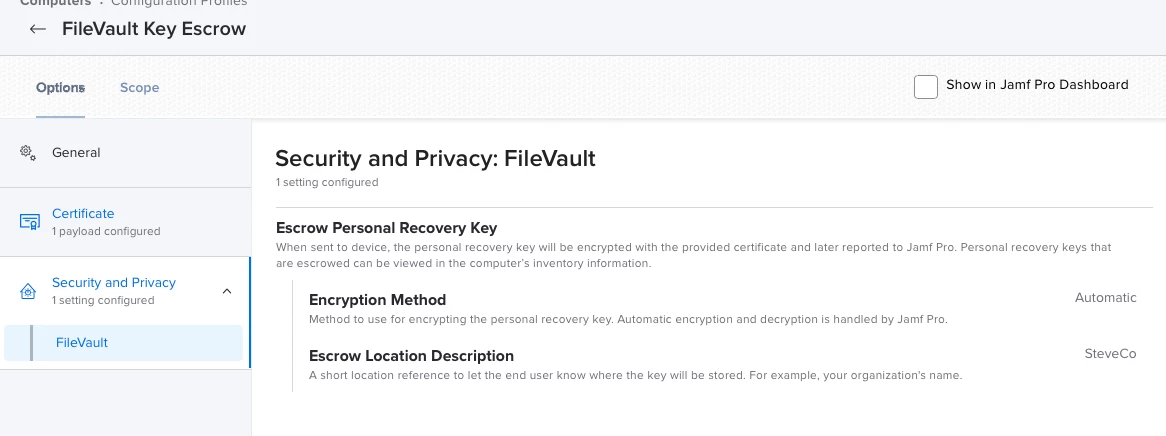

As far as the PRK being escrowed, you have to have a configuration profile in place to escrow the key before FileVault is enabled. If you do not, then you will have to change the recovery key on the machines after the profile is in place. The profile only needs hte "Escrow Personal Recovery Key" keys in the Security and Privacy payload. The "Certificate" payload is auto configured when you save the profile.
Once you have that in place you can use a script like this reissueKey.sh script to prompt users to change the Personal Recovery Key.
