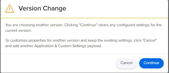

I tried cloning then changing the JC version and I get this message:

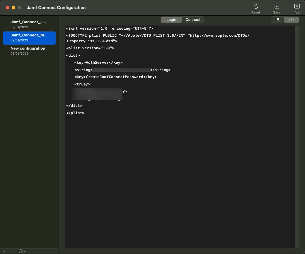

JAMF does not even recommend updating this configuration profile within JAMF Pro. When you change the version it will clear out all of your configuration. Just make a copy of your existing config, unscope the copy and replace the xml in the existing config and deploy it.
Use the JAMF Connect Configration.app, you can make the changes with a GUI. Then get the xml from JAMF Connect Configuration (click the </> icon) and paste it in to your configuration profile and save and update all devices. Test before you deploy.

And when selecting the new version it does clear out all the variables you have set.
I understand why the values clear out when you change the JAMF Application Domain Version. However with JAMF Connect being 1st party JAMF really needs a better built in solution. I am sure they could figure a way to update the version without clearing the XML.

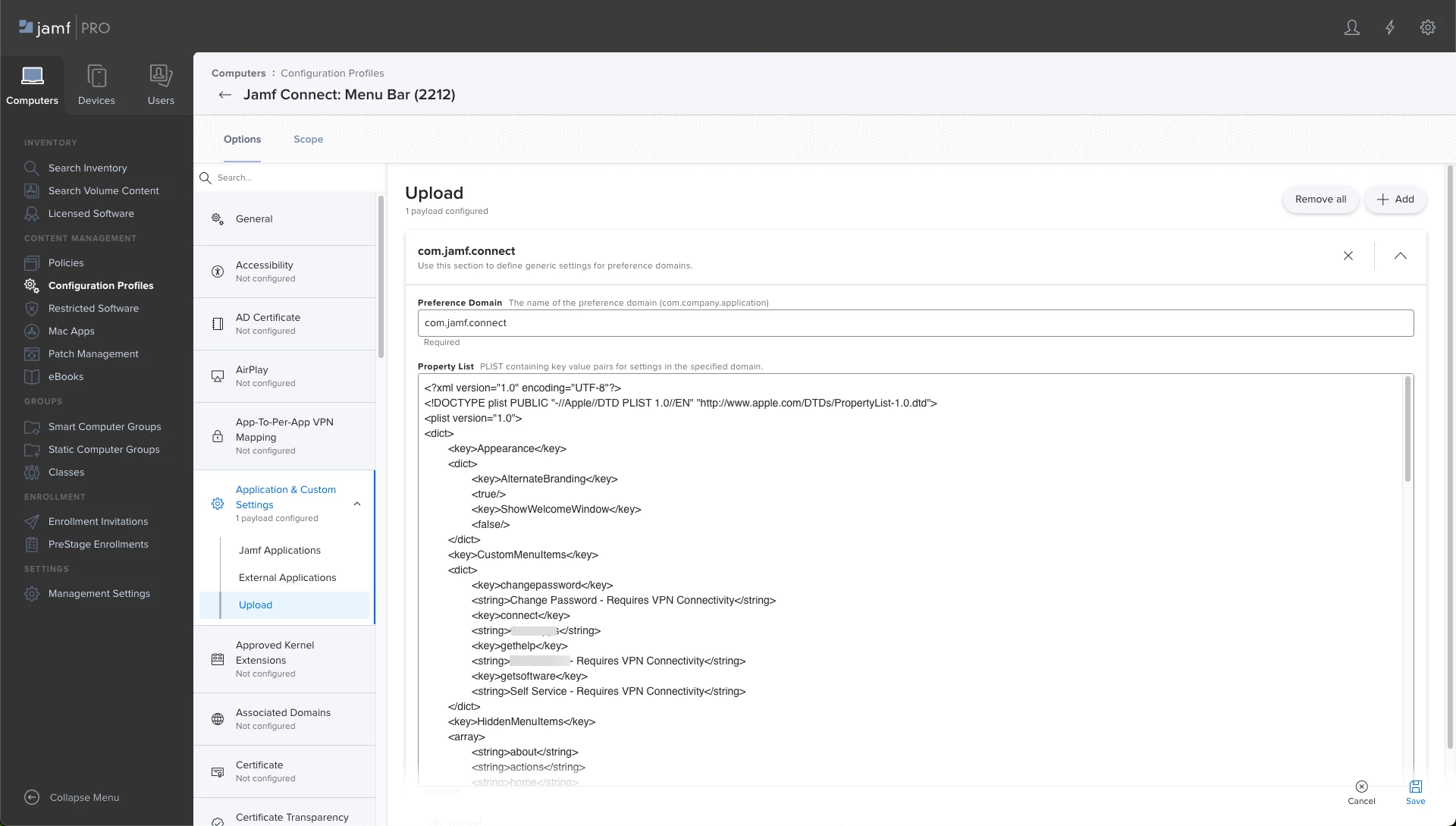

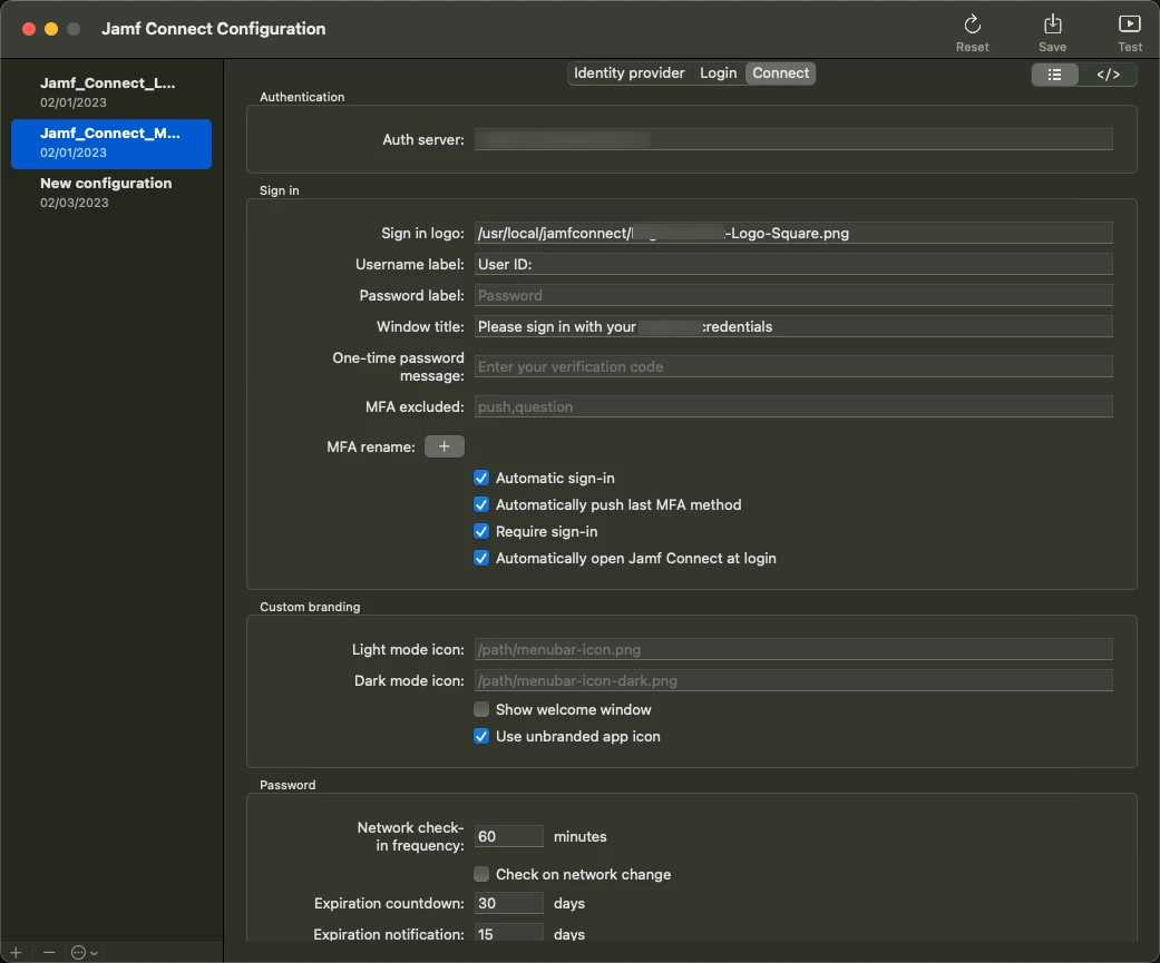

@AJPinto Sorry to revisit this so many months later, finally getting around to upgrading our Jamf Connect to support Sonoma, but i have a couple questions.
I used the Jamf Connect Configuration app, before we manually in Jamf Pro configured the configuration profile with both com.jamf.connect and com.jamf.connect.login preference domain properties in 1 single profile with the version selected and the variant .json. It doesn't seem you can select these properties from the JC Config app. Is that correct? Also should i separate both the JC connect and JC connect login .mobileconfig that the app creates or upload them to 1 single CP? and also does that mean that the Configuration profile you create can be used for any upgrade version in the future (as long as your not using any of the new functionality and that your existing configurations haven't changed in the new functionality since it just applies to the Custom ?
