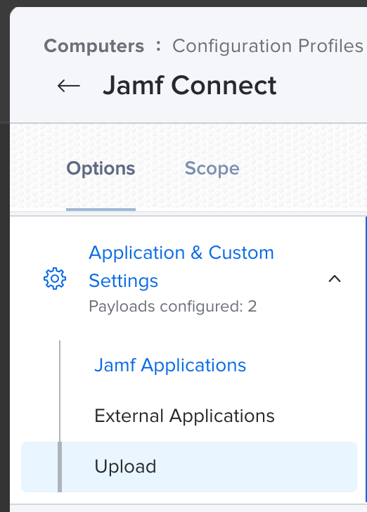

I believe it should populate under the "Applications & Custom Settings" Payload. BUT I HIGHLY HIGHLY HIGHLY Recommend using the built in "Jamf Applications" Payload to Configure Jamf Connect. I have had nothing but bad experiences with the Jamf Connect Configuration Tool.

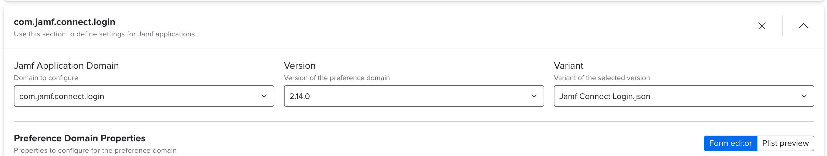

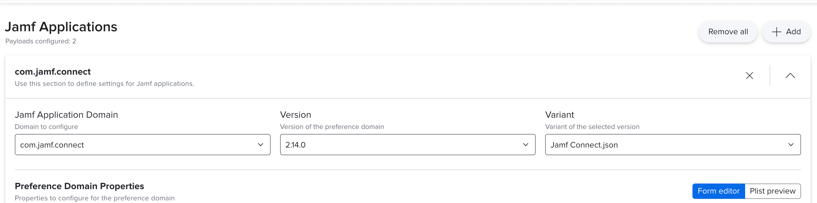

@binjali  You want to create 2.
1st is Jamf Connect & 2nd is Jamf Connect Login
binjali
  • Aug 18, 2022 11:06 PM UTC
Can i do them inside the same configuration profiles or do i have to make separate configs?
Hugonaut
Forum|alt.badge.img+15
  • Aug 18, 2022 11:18 PM UTC
Either Or.
I package them together. But you can package them separately if you'd like.
