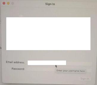

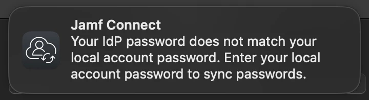

We have an issue where some machines keep prompting the user that their IdP password does not match their local password and are given the option to sync. However, when you hit sync, the login popup is completely greyed out (as shown below).
In all cases, we have verified that the password is in fact the same. I'm assuming this is cached somewhere and maybe needs to be cleared? Has anyone seen this?

I've seen this behavior intermittently. I've been back and forth with Jamf Connect for a while and it was identified as a product bug and will hopefully be fixed in the near future. For reference I've seen this issue since ~March of this year, updating every version of JC, with Azure as my IDP. I do more often see this on non-ADE enrolled machines as well.
My issue around this was documented as PI111500. My issue appears to be caused by the com.jamf.connect.state file at Users/$user/Library/Preferences having the "PasswordCurrent" value be set incorrectly (seemingly randomly), and JC doesn't update it right away.
This issue is usually random, or at least transient, and usually goes away on its own after a little while (in my environment anyway). A workaround is manually setting the "PasswordCurrent" value in the aforementioned plist file to be 1.

@rpayne the grayed-out sign in window makes me think that license file may have expired or is missing. If the About menu is displayed in the dropdown menu, take a look in there for any messages.

try reinstalling Jamf Connect

I forgot to update. Right after posting this, we reinstalled the latest connect. This fixed the greyed out. It still prompts for IdP sync though. It will accept the password, go away, and then reappear prompting for sync 30 seconds later.
