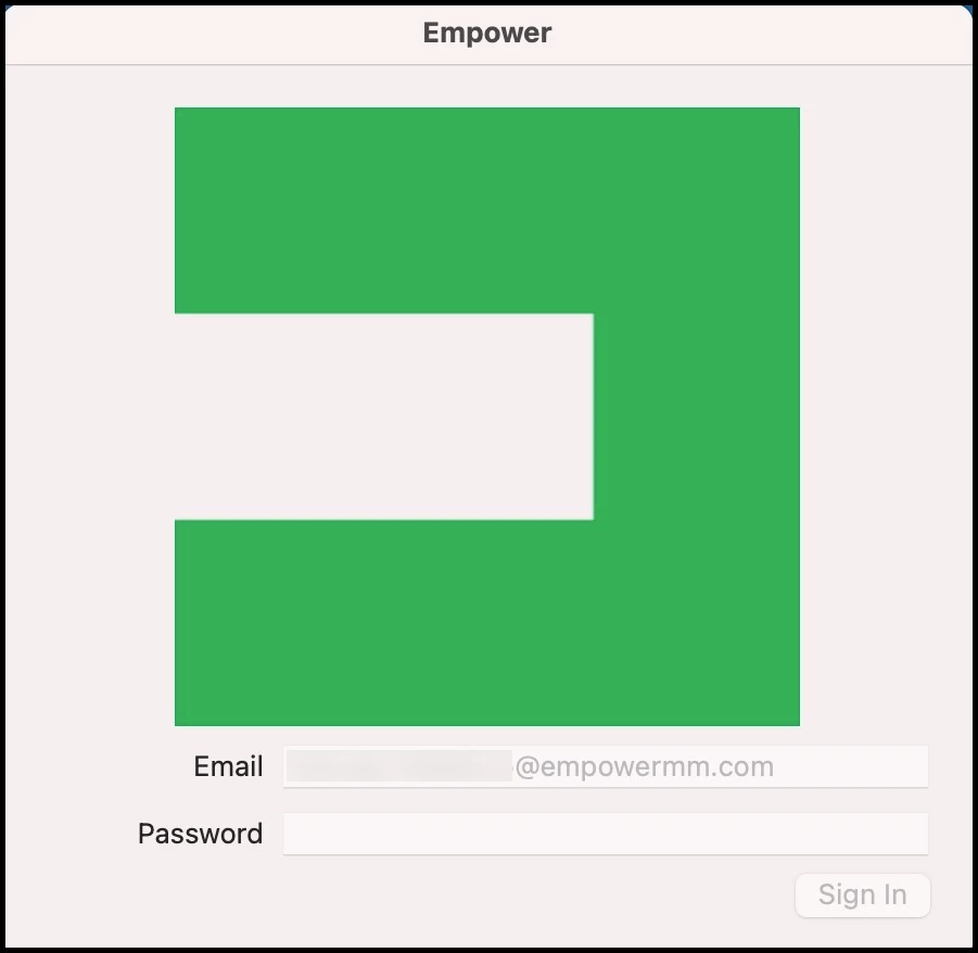

dgarrigan
Has anyone had this issue with Jamf Connect? It is becoming a widespread problem within our organization.  This (attached photo) will pop up upon login and you can't make it go away.   We thought updating everyone 2.12 would solve this problem but it's still happening.  The only fix that we've found that works is going in and manually re-installing (via Jamf id site) the latest version.  I'd like to avoid manually re-installing for our whole environment so any help/ideas would be greatly appreciated.

The greyed out login abilities are sometimes associated with a bad License in the configuration profile. @dgarrigan

JAMF Recommends that you create a Config profile to house just the license file for the JAMF Connect configuration and put all of the other settings into another profile. This allows you to change the license file without touching the rest of the JAMF Connect config or any other payloads that you may have bundled together

HI, you will need to get the user with that issue to be excluded from the license file, then re-add the license file again. Sometimes you might need the user to restart for the Jamf Connect popup to go away/come back to normal where you can login instead of greyed out.
