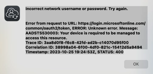

I've updated a few test machines to 2.28.1.  Since doing so, I'm getting this error.  We are using a conditional access policy with Intune Integration.   Worked fine before upgrading from 2.26 to 2.28.1.   Any ideas?  If I exclude my userid from the CA policy, it works fine.  My initial thought was to exclude the Jamf Connect app from the policy, but wanted to post this first.

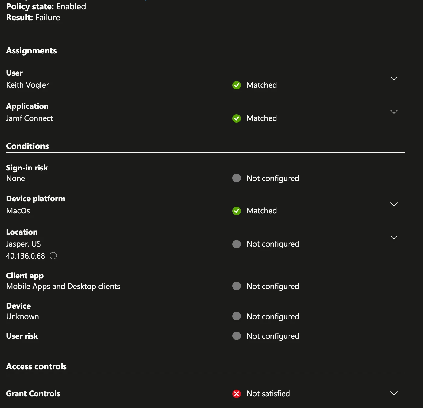

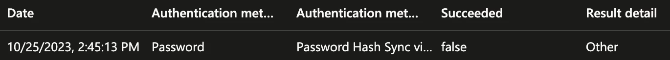

Here is the Entra sign in log.

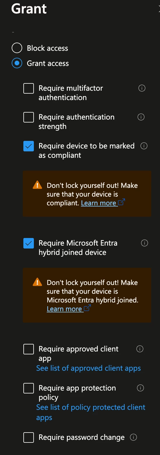

Here is the policy.  Only require 1 of the 2 checked.  It targets all cloud apps.

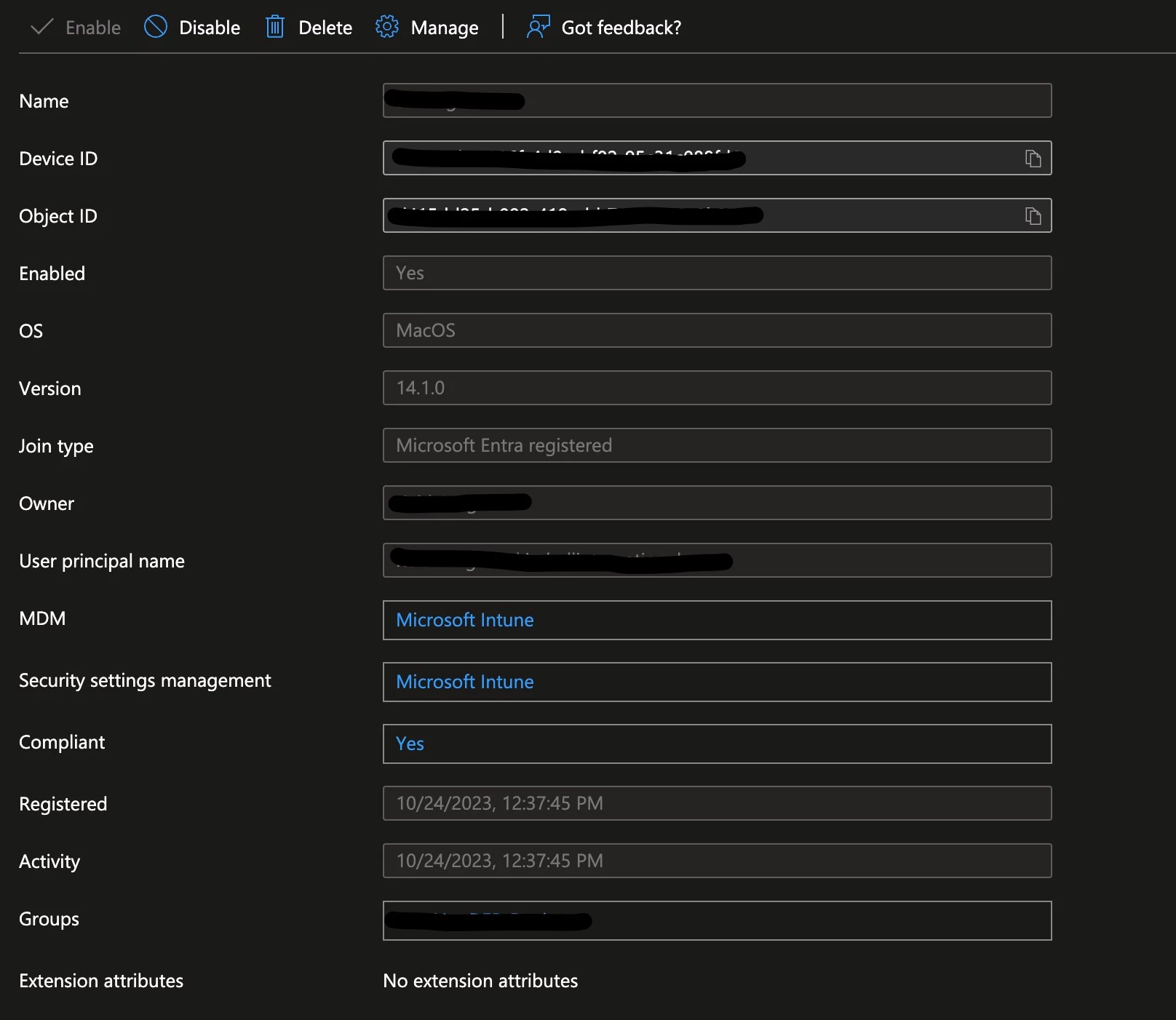

Here is my test machine in Entra.

Not sure at what stage you are having an issue, but make sure you are running the latest MS Company Portal that just dropped today version 5.2310.4. We had some SSO issues until we updated our app form 5.2310.3 to 5.2310.4..
  • Oct 26, 2023 12:58 PM UTC
Thanks mojo!  That fixed the issue!
  • Oct 26, 2023 1:59 PM UTC
Looks like I spoke too soon.  I didn't wait long enough after adding myself back into the CA policy.  Once the policy was back in place, I get the same error.  Time to open a ticket.
