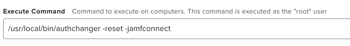

  • Create a a new policy and scope it to the impacted devices
  • As mentioned above in the policy payload under ‘files and processes’ add the command /usr/local/bin/authchanger -reset -jamfconnect
  • Mar 18, 2022 9:52 PM UTC

Are you sure you made the policy like showing below?
  • Mar 29, 2022 1:14 AM UTC

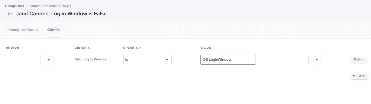

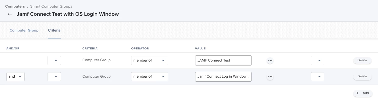

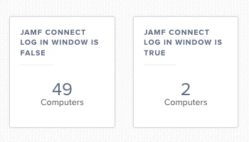

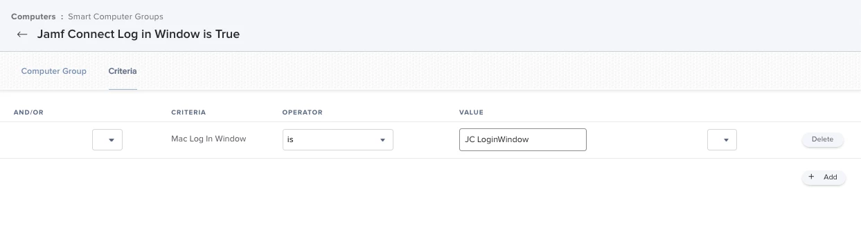

Yes. I created the extension attribute then created 2 smart groups. "Jamf Connect Log In Window is False/True"
I am still in testing so I made a 3rd smart group that includes the test group AND falls in the Mac OS Log in false.
