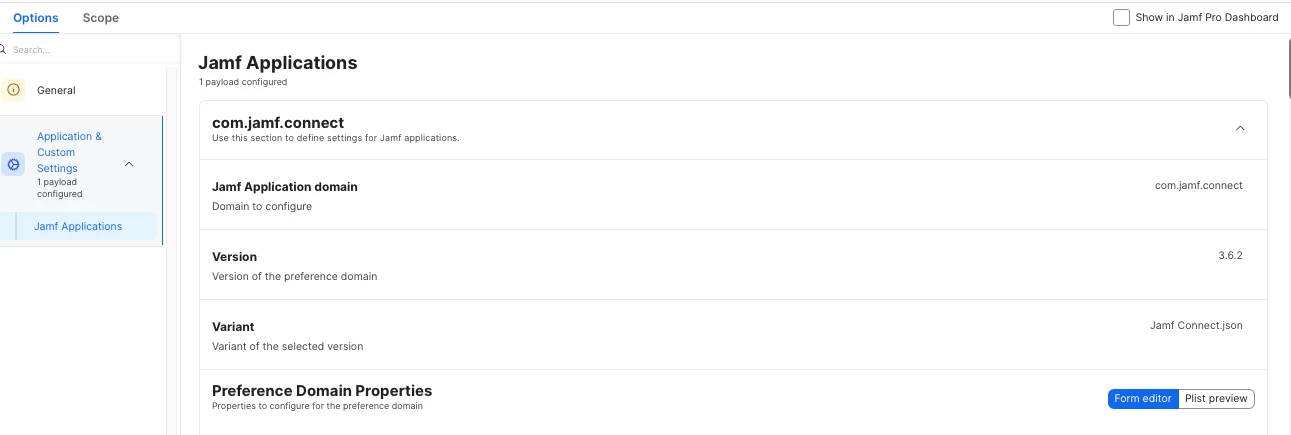

One thing I haven’t found the answer for yet…
In the configuration profile for Jamf Connect, The Application Setting Payload has a field for “Version”.  Should I be updating this as new releases of Jamf Connect come out?
Thanks in advance.

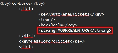

After a good few weeks of digging into this for my organization, I found the solution to be simple, and something easily overlooked. Despite our Menu Bar Configuration working for months, the error was in the Realm ID, specifically ensuring that it's not lower case, but UPPER CASE.
This string of the JAMF Menu Bar in particular. After editing it and pushing the Configuration Profile back out, we were in business again. Make sure you do the kpasswd test in Terminal. If passwords can be changed that way, then it's not a problem with AD or Entra, it's in the configuration profile. Hope this helps someone!
Low73
  • Jun 22, 2026 5:04 PM UTC
This string of the JAMF Menu Bar in particular. After editing it and pushing the Configuration Profile back, we were in business again. Make sure you do the kpasswd test in Terminal. If passwords can be changed that way, then it's not a problem with AD or Entra, it's in the configuration profile. Hope this helps someone!
Hey ! thank you for the update but just to be clear it needs to be in uppercase ? Because ours is in uppercase and we still have the issue… :P
MMontgomery
  • Jun 22, 2026 5:28 PM UTC

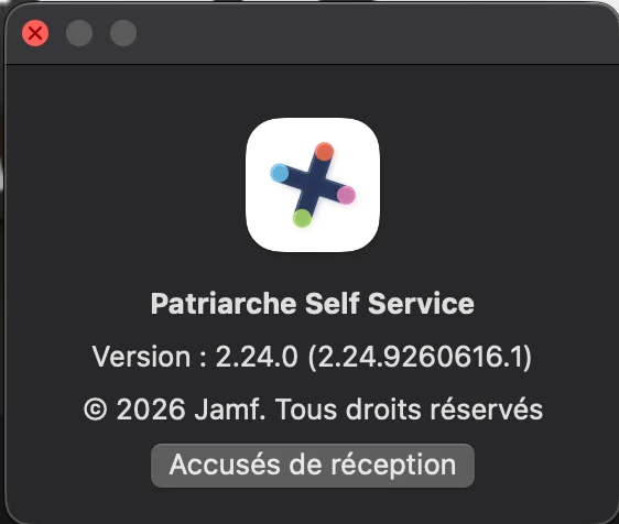

Correct, must be Upper Case. Sorry yours is still giving you issues. :( I also pushed through the newest Self Service+, apparently 6/8/2026 they released a new update for it that helped with Kerberos Ticket issues. Also, looks like they launch 2.24.0 today, not too sure what all that entails.
Low73
  • Jun 22, 2026 5:31 PM UTC
ok cheers !! ours have been upgrade by itself
guess i’ll have to try with this version ;)
