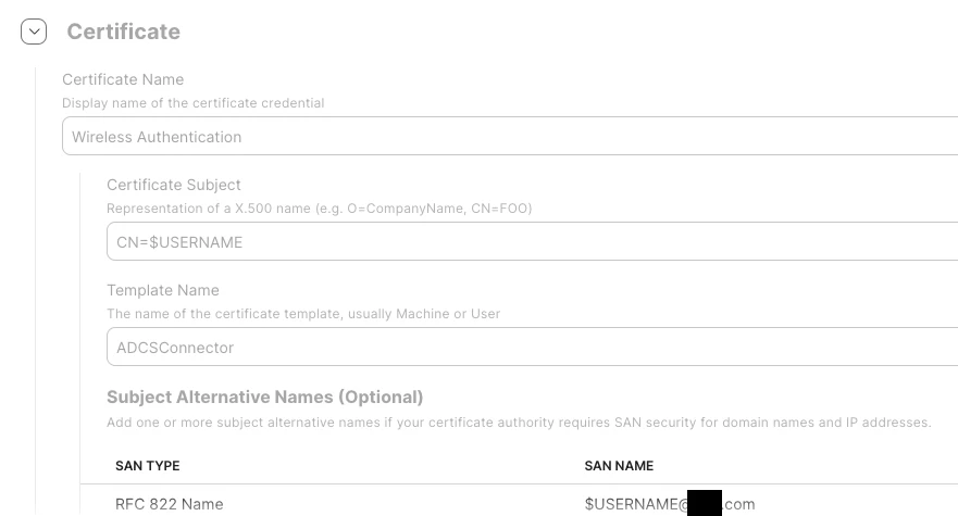

@jakeobbewe're using user based authentication in ISE. My certificate subject is CN=$USERNAME@domain.com, my SAN type is RFC R22 Name, and my SAN is $USERNAME@domain.com.

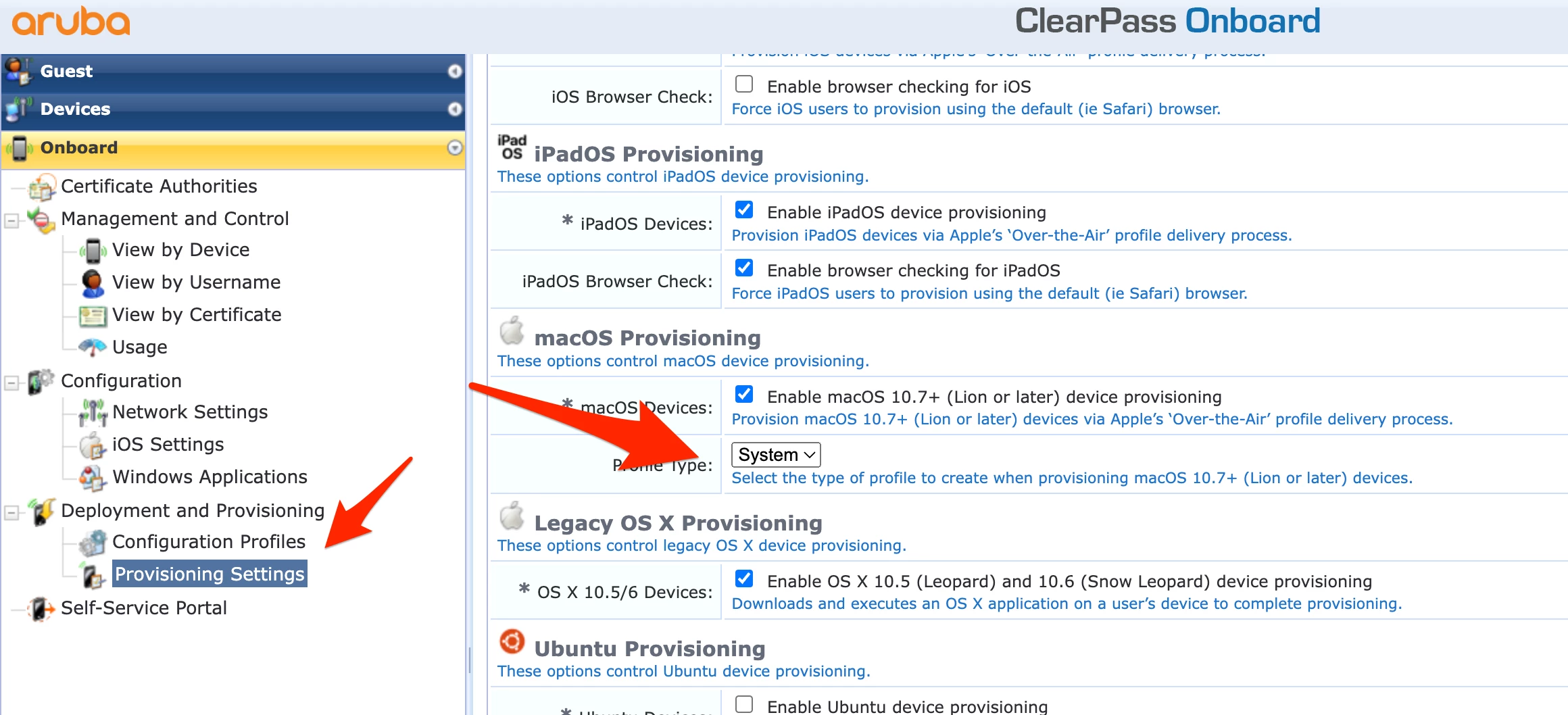

Hi jalcantara,
We use Aruba brand Access Points in our WIFI network. 802.1x is used to connect to the network through these products and we include users in the network by verifying with a certificate. At this stage, identity and certificate verification is done with an application called ClearPass. The ClearPass application also serves as an MDM server and SCEP server. When we connect to Access Points, the ClearPass application sends a profile file to users via a web interface. Actually the whole solution is contained in this profile file settings. We changed the part specified as "user" in the settings of this configuration profile file, sent to MacOS devices by the ClearPass application, to "system". Thus, as soon as our MacOS device was turned on, the user was able to connect to the network automatically without logging in. If the application you use is ClearPass, I can support this article with screenshots.
husnudagidir
Hello @husnudagidir  I would like to learn more about your solve for the 802.1x problem. Currently using Meraki Radius authentication with EAP-PEAP.
Hi jalcantara,
We use Aruba brand Access Points in our WIFI network. 802.1x is used to connect to the network through these products and we include users in the network by verifying with a certificate. At this stage, identity and certificate verification is done with an application called ClearPass. The ClearPass application also serves as an MDM server and SCEP server. When we connect to Access Points, the ClearPass application sends a profile file to users via a web interface. Actually the whole solution is contained in this profile file settings. We changed the part specified as "user" in the settings of this configuration profile file, sent to MacOS devices by the ClearPass application, to "system". Thus, as soon as our MacOS device was turned on, the user was able to connect to the network automatically without logging in. If the application you use is ClearPass, I support this article with screenshots. You can use the screenshot below. After making this change, you need to delete and reinstall the WIFI profile on the macOS device. After this step, the problem disappears.

You basically need to dupe your radius server into thinking your machine cert is a user cert. In your profile change the device level to computer and use $Username as the subject. Wireless should work at the login screen after doing this.
