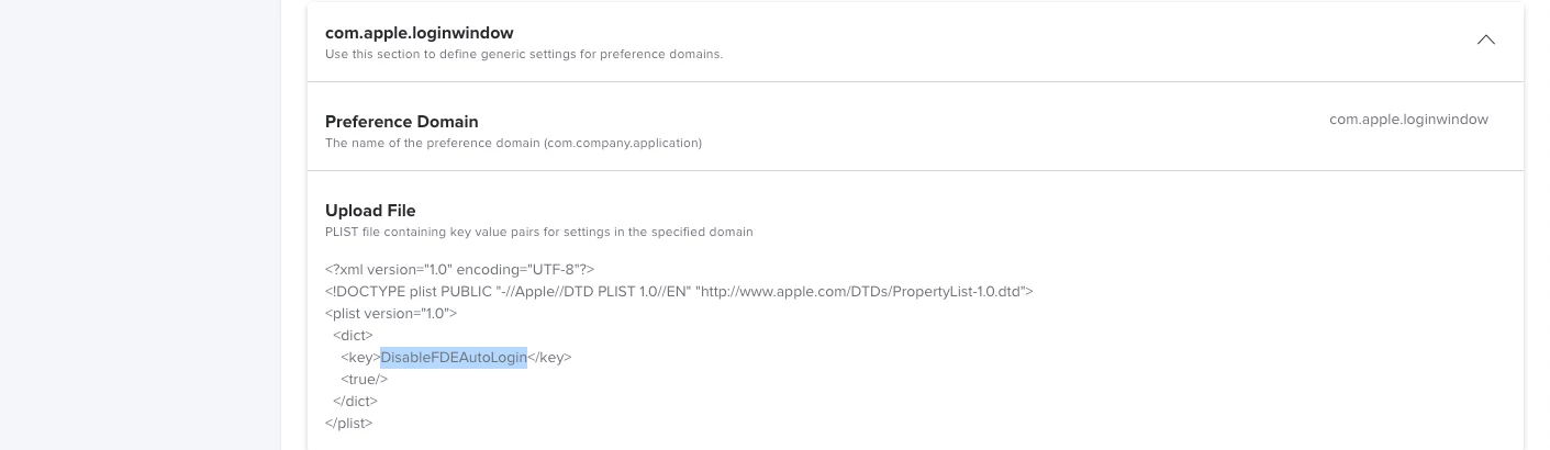

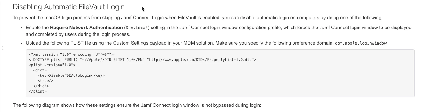

The reason that your Jamf Connect login is being skipped is because the DisableFDEAutoLogin key needs to be set to true. Simply add this key to your Jamf Connect Login configuration profile to stop the this behavior. Read more below:
